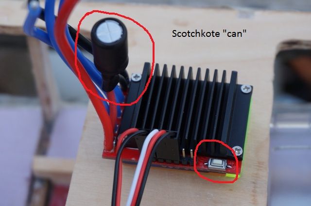

    Picked up the ESC and Motor yesterday, and I have a couple of more questions at this point.
    Remove 4 screws Skotchkote or epoxy on the board. Both will work, is there a preference?
    I assume that the “can” on the outside also gets coated in Skotchkote?
    What about the Key/switch. I bought the programming card.
    On off switch. I see it as a point of failure. Should I be able to get a jumper so that it is always on when the battery is plugged in?

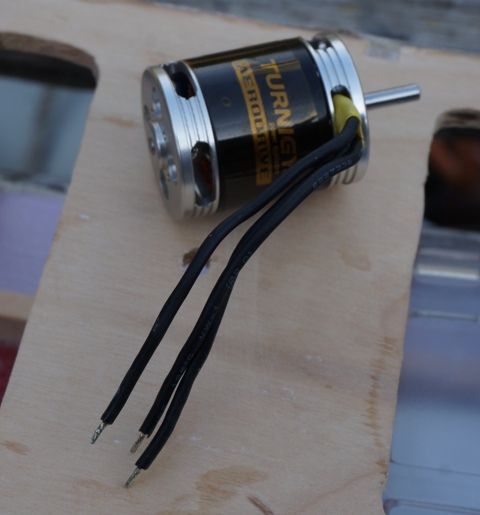

    Three blue wires on ESC, Three Black wires on the motor. Surly it must matter what order you connect them. :confused:
    Keith
  16. Beaver
    Skotchcoat or epoxy, both work fine. I've recently been using E6000 adhesive to waterproof stuff. Works very well, and is flexible.
    You can waterproof the can. I'm not sure if it makes a difference. I would just make sure to coat the solder joint to reduce corrosion.
    The key button, I've never had any trouble with it, and I never coated it in anything. If you don't plan on using it, might as well coat it in something to reduce the possibility of something going wrong.
    The on/off switch will need waterproof if you expect it to last very long. I'm not sure how to do it myself, but somebody else might know.
    There is no particular order that the wires need to be in. Hook the wires up and it will work, just might not spin in the right direction. If the motor is not spinning in the desired direction, just swap two of the three wires, and the motor will reverse.
  17. absolutek
    I prefer using epoxy, as its more readily available. Skotchkote will work also, they are both good IMHO. That can is a capacitor, I just dripped some epoxy on the leads on the bottom side till the shrinkwrap was filled I don't believe any other part of the capacitor requires waterproofing. I believe the button is for programming the ESC without the card, since you have the card, feel free to epoxy over it. I haven't had the "on/off" switches fail on either of the ESCs I use yet. You can jumper the connection so that it is on when the battery is connected, I know some people do, or just wait till the switch fails. The three wires that go to the motor, it does not really matter what order you connect them in, unless the motor is spinning in the wrong direction. Then you can either just swap two of the leads, or reverse the channel on your radio transmitter.
    Hope that helps some.

    I have all three. Epoxy, Scotchkote, and E6000, I think I’ll go with the Scotchkote. I’ll order some jumpers off e-bay. Looks like I can get 100 shipping included for $0.99 from China. (How do they do that???). I’ll leave the key/switch for now. I want to see how the programming card works.

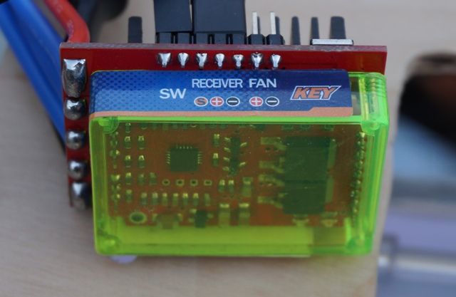

    I've done 10 of these. On off switch, replace with a jumper. Scotchcoat the key switch, even if you epoxy everything else. The card is unreliable and probably will not last a year. I scotchcoat all the wires where they enter the insulation at either end (I assume they corrode when wet inside the insulation, especially in cuso4 laden water). I got lazy on the last 6 and just scotchcoated the outside case, including the edge of the heatsink. The moisture sensitive mosfets are under the heatsink, the heatsink cannot be removed without destroying them if you fill the case with epoxy. The first batch I did I filled the yellow case with epoxy and encased the outside in epoxy up to the heatsink. I had one of the first batch (100A) fail after a year, post mortem indicated a mosfet overheat and failure due to water infiltrating an air bubble in the epoxy under the heatsink. The rest seem to be doing OK, haven't gotten an involuntary immersion test yet though on the scotchcoat only version. Use 4mm gold plated bullet connectors, male end on the motor. It may be a good idea to add more scotchcoat every year or two, don't know about it's durability

    :crying: Well after opening the yellow case the circit board is two layers. No way to get scotchkote on all surfaces. I covered everythin with epoxy, then filled the case with epoxy. I will follow up with scotchkote on exterior.
