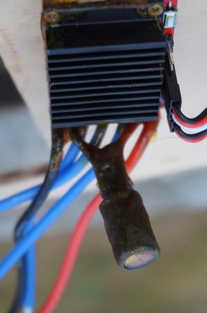

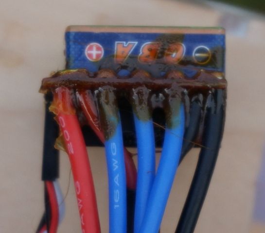

    Here is the case filled with epoxy. I poured epoxy through the 2 circuit boards then filled the plastic lid and slowly pushed the circuit board into the lid and screwed it back together. Plenty of squeeze out. 2 tiny bubbles.
    After it dried I used Scotchkote around the exterior. I will come back to the key switch after I am satisfied that I can make everything work with the programming card.

    Scotchkote may work well but it sure is ugly compared to E6000! :cry:

    Its a PITA to work with as well. :blink:
    I don't care if it is ungly. Nobody should be looking at stuff on the inside.
    I like Scotchkote. Works in real-navy saltwater applications, it'll do for my boats :)
