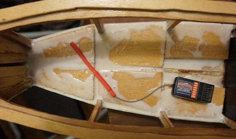

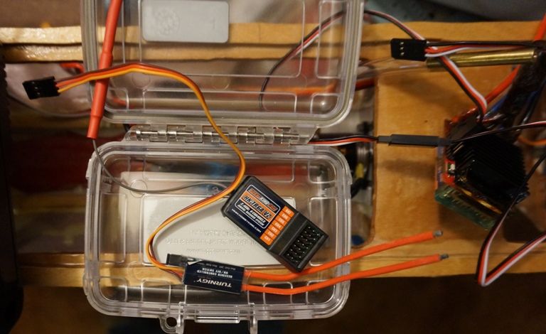

    I decided to go ahead and get a new radio for the William Dawes. I got the cheap HK 6 channel for the convoy ship.
    I had originally planned to use the old 2 channel from the Komet, but decided to just leave it in the Komet.
    This will be my first 2.4 GHz radio.
    1. Is that really all there is to the antenna?
    2. ESC – If I am reading wiring diagrams correctly I do not need to have a battery plug in. just plug in the ECS?
    3. I will be using the Turnigy receiver controlled on/off switch for the micro pump. 10Amp should be sufficient for a micro pump?
    I am starting to lean toward no radio box for this. If I use servo lead extensions, I should be able to completely goop up the receiver and the switch with Scotchcoat.
  5. Beaver
    Yup, that's all there is to it.
    2nd question- Are you talking about power for the receiver? If so, the ESC should have a battery eliminator circuit (BEC). That will power the receiver and the servos and whatever else that needs power from the RC.

  7. Maxspin
    Maxspin -->> C T D <<--
    Jul 30, 2014
    634
    Yelm, Washington
    Yes the ESC has a BEC. :)
  8. Beaver
    Then you should be good. Lib is looking great, looking forward to seeing shots of her on the water. :)

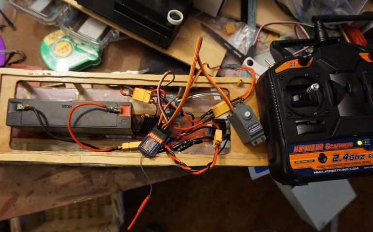

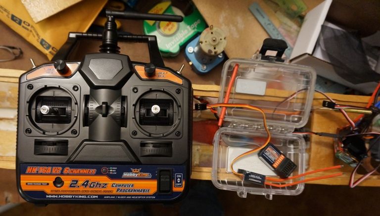

    It looks a mess…..
    Motor goes forward and reverse. Ruder servo works. Pump turns on & off. Need to play with the ESC program card. I have a pause between forward and reverse. I didn’t have time to play with it last night. The pump works, but on the dial not the switch….:confused:
    I still need to color code the plugs.
    Still waiting on parts for my rudder servo mounting. I want to get that mounted before I skin her.
  13. Tugboat
    To fix the fwd-reverse pause thing, plug it into the programming card and set run mode to TWO.
  14. NickMyers
    The switches on that radio are not channels.
  15. Maxspin
    Jul 30, 2014
    634
    Yelm, Washington
    Thanks Clark,
    I had read a post where you walked through the programming card, but couldn’t remember where it was. Fixed the reverse to run 100% as well.
    Thanks Nick,
    I will quit trying to figure out the switches. Dial works.
    Keith
    Happy to help, I battled for several months with that annoying pause before Mike Mangus let me in on the secret :)
  17. Maxspin
    Jul 30, 2014
    634
    Yelm, Washington
    It all started with a bad solder on the Battery lead……..:blush:
    Of course I had already thoroughly covered in Scotchkote……..
    Easy to just make a new one……
    I checked I tell you….. Red to + Black to - .
    SMOKE, popping, bad stuff…..:pinch::crying:
    I checked, I tell you, I did…..:mad:
    Some how some way, there it was Black to + Red to -. :blush:
    One dead ESC.
    Good thing I bought the cheap one. Good thing I bought a spare.
