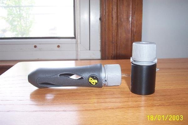

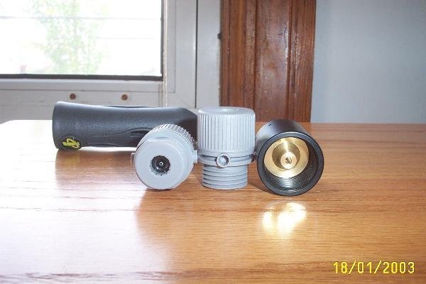

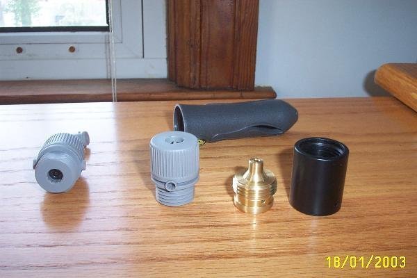

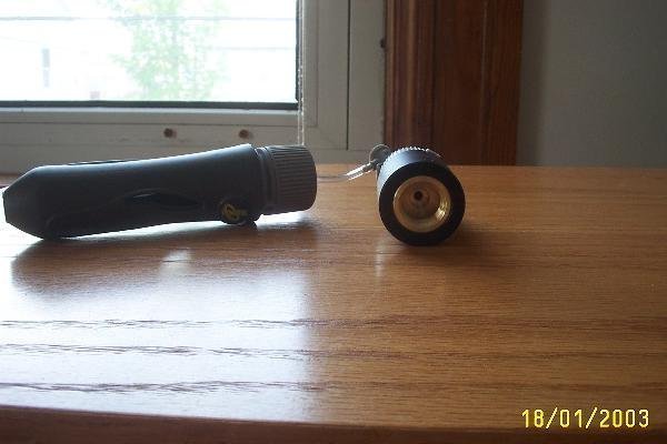

    pics of the reg and adapter cup and 16gm cup

    that sounds good but if you look at the brass insert there is a nipple that goes up into the bottom of the reg and seals against an O-ring, this would be nessary on the adapter. I can take my calipers and measure all the parts and give Palmer a callto see if it would be possibleto make, I don't think it would be wise to "hide" from him what we're trying to do as he brobably looks at this site and might get offended later. plus it would be helpful for them to see the pics to understand whats needed

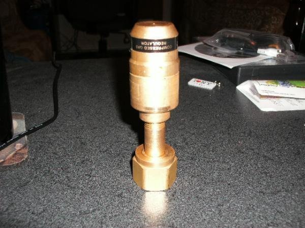

    Found a fixed 150 psi regulator I purchased for $40, and will try in the next week or so. I does have a 1/4 inch port, so I will need to get a adapter for it.

    I use the Strike Models small regulator with the set 150psi. Very good and fits well in my Gearing! It can be used with a capsule adapter or a bottle.
