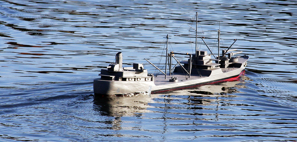

    It's always more fun to shoot back, no matter the caliber. In the latter part of WWII, USN ships were commonly armed with as many as four 5" guns. In Big Gun, that means you can arm something like the Cimarron or other large auxiliary ship with as many as 4 bb guns. If you work out the mechanics of reliability, that means you could - in theory -fire 4 bbs every 4 seconds. I eventually scrapped the forward rotating guns on my Cimarron below, but kept the rotating cannon in the stern. I've had a lot of fun over the years with it.
