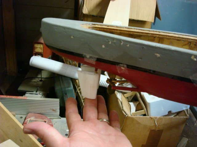

    SWEET!! Rick is awesome. What kind of rudders are you using? If you want them, I can cast you a set of the fatty airfoil ones like I made for Christopher's Bayern. That'd give GW fatty rudders for dual ruddered classes 4, 5, and 6.

    Clark can you send me some pictures of those rudders. I was going to attempt to make some this week.

    The previous owner had great damage control, but he chose to drive the outer shafts vice the single center shaft. In fast gun, that's a no-no as turning performance is greatly degraded. So I bought Big Scharnie from him (pretty ship, could not resist!!) (did I mention that I have a disease?) and have refitted it with a center shaft, and two fatty rudders. Since I have an HMS Indomitable refit going on as a 'while epoxy dries' project, I went ahead and shaped plugs for fatty rudders for class 4 dual rudders as well. I do need to do class six for the Bismarck boys some time. The Bayern with the fatties turns really well, now that new-ship overweight issues have been resolved.

    You dont think you should of put the posts more to the center? The way you have them towards the front will put considerbly more stress on the servo, since the rudders are not balanced. Also doing that would move them closer to the propeller. Just a thought, at times pictures may not make it totally clear due to the angles.
  18. Tugboat
    The posts ARE very close to the front, and there's a reason for it :) The current rudder stuffing tubes are further back from the prop than is ideal, but that's where Bill put them in his old setup. I'd say the leading edge of the rudders is about 1/4" back from the prop blades. The angle is wierd, makes the port rudder look like it's set farther aft than the stbd one, too. This was the only pic I have of the fatties, so I posted it for Johnny to look at. The torque on the rudder servo is not such a big deal, as I use a servo rated for the load*, and encourage everyone to do so, regardless of their rudder design. Overloading servos kills them... For this application, I'd either use a single large hi-torque servo, or two standard ones. For the Moose, I'm using two hi-torque servos with metal gears and metal horns. Banzai!^3
