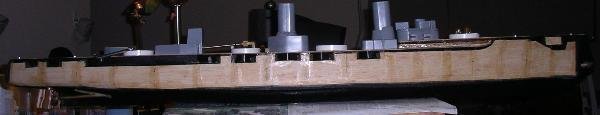

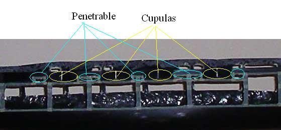

  8. SnipeHunter
    Here are the pictures of how I cut out the hull of my fiberglass VDT, I hope they help you out. Casemates are pretty crazy, the rules are vague at best, the four VDTs at MWCI NATS this year were all cut slightly different so I wouldn't worry about it to much. People are going to ask you about it and tell you what they think you should do either way. Don't worry about it too much for your first boat, get the boat on the water thats more important than a casemate thats off 1/8". Hope these pics help!
  9. BoomerBoy17
    That ship looks sharp Chris, and yea, these pics should definately help.
  10. zackcon2
    zackcon2 Member
    Jul 6, 2007
    144
    yes the rules are not very detailed ,but thanks for the pics and ansers that will help alot.
