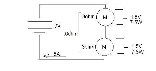

    Lets just do it this way.
    Here is the best case scenario, both motors are matched perfectly in manufacture, speed, resistance, and (CEMF) load.
    As expected, each motor is dissipating the exact same power, 7.5W.

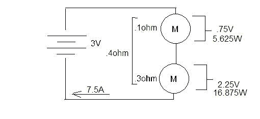

    Here are the same motors only the top motor now has a higher (CEMF) load. For example, it got a few blades of grass stuck in it which is causing more resistance against the water.
    The resistance of the motor goes down, lets say by 1/3, trying to compensate for the increased load. This will reduce the overall resistance of the system, which increases current. Which is good.
    HOWEVER, the top motor is now at .1 ohms. Which means it drops (V=IR) .75V and therefore 5.625 watts. Therefore it will slow down (lower power, and higher load).
    ADDITIONALLY, the lower motor is still at .3 ohms. And with the increased current, will drop 2.25V & 16.875W. Therefore it will speed up (to probably over twice as fast).
    So, as load is added to a motor in series it dissipates less power therefore providing less torque to the props. Looking at these results, it is no wonder Carl's Scharny drove in circles.

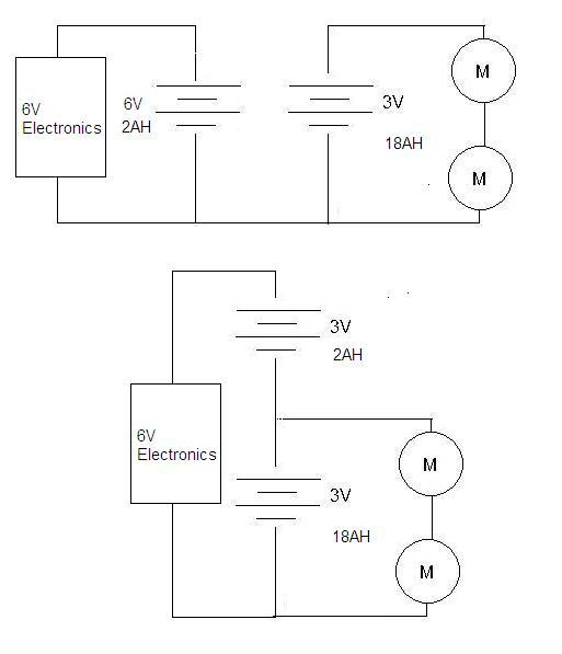

    Additionally,
    Both of these configurations are valid. However the first one is probably the best of the two. Less dependencies = less problems. Addtionally, if the motors eat all their power the cannons can still fire.
    The grounds are connected for a reason. Remember to do so. Floating grounds are never a good thing.
    Note: you can run whatever AH you want.. I just put something down.
  20. JustinScott
    JustinScott Well-Known Member
    2,238
    Ooops.. scratch that the bottom one is bad b/c of the noise it would incur on the electronics.
