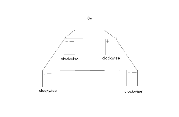

    Thinking of the 'shooting when the power is out' is there a switch I could use to switch the reciever from the main battery to a reciever battery when the main battery drops too low to support the firing of the cannons?

    If you use my first battery wire pattern, you will be able to run your boat to a stand-still & sill be able to shoot until you are out of C02 or shells. or both. If you are running a 7.2 backup & a xV main I suggest just using the 7.2 for electronics & xV for motors.. Less complicated, more robust.
    Otherwise, I suggest using a diode between the main & the backup so the main charges the backup, but the diode prevents the other way around. Then just run the electrics off the backup. SO, basically take my first batter wire pattern and put a diode between the batteries '+' symbol. Diode needs to be facing the main battery. I think you would be happier with two batteries with the same V though.

    Thanks to my own personal laziness & a fluke by one of our new members...
    Visit this site
    Notice how they are wired,
    Notice the one with a prop (higher load) starts to spin & then stops.
    Additionally, you can hear one of the others (probably the other motor in series with the prop) spin up very very high.
    Update from other thread... The one that didn't spin was the only motor with a load on it.
