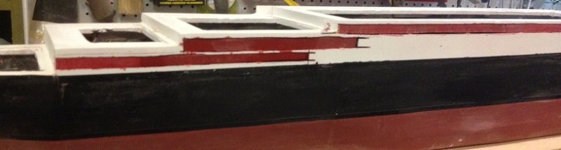

    Side is on and painted, still have to add the tape that will simulate the windows (to survive bb impacts).

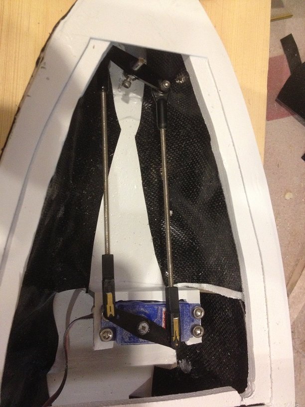

    Rudder servo is in, a tapped aluminum right angle that will not move (this will please Allied Admiral Pete).

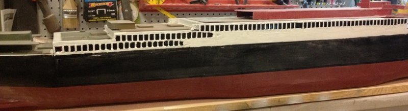

    Was not able to find tape in the correct width, and after trying a few alternatives I bit the bullet and cut the hull. The windows need to be finished, but you get the general idea. The inset is 3/8 of an inch with the flat portion being painted black, then the windows themselves will be strips of plastic/fiberglass and painted white.

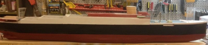

    installed the windows, not happy that I used a course brush to paint the white areas. Will sand and fill in the black with a paint pen. Will also further define the windows with strips of plastic to give it a more refined look.
