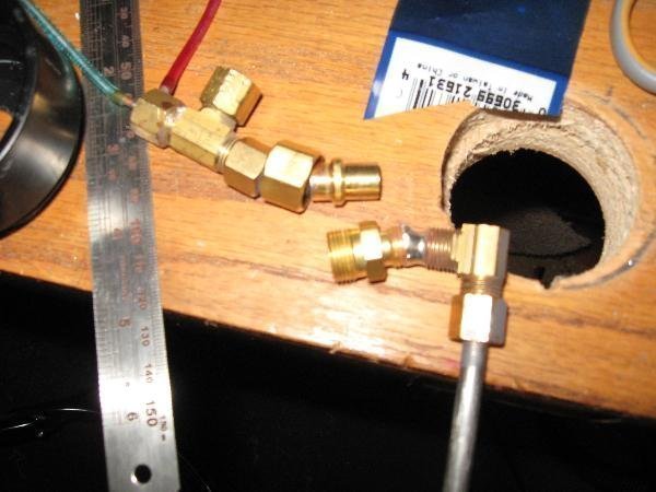

    Over all view, the part that I made is the fitting between the breach and the T.
    The gun goes out the center barrel of a triple mounting, so when you turn the turret the magazine stays in place, just the gun rotates.

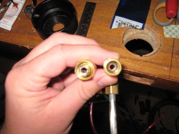

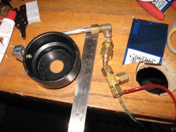

    [​IMG] This is a crummy picture the autofocus was unhappy, there is an O ring on one side and a grove for the seal in the other.
    Lastly is the parts all disconnected.
