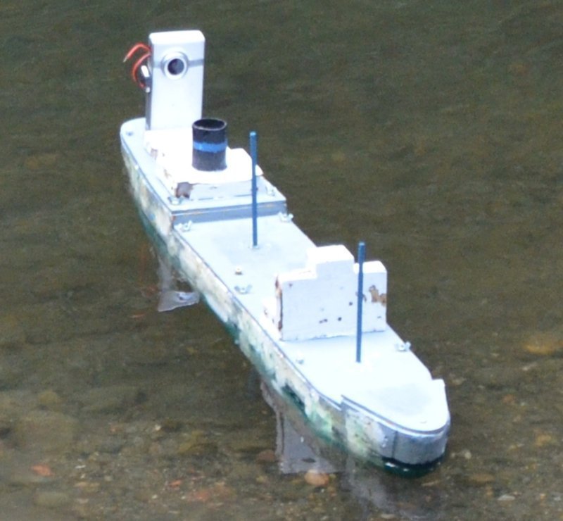

    Last night I attached a FlipCam to the sterndeck of my Maru. Today it sailed in 3 sorties and sank 3 times. I obtained usable video out of all 3 sorties.
    This is the rough cut of the first sortie - there is very little audio, mostly only when guns fire nearby - this is primarily due to a problem with the flipcam's onboard audio processing (part of the reason im willing to attach it to a ship I know will be sunk). Only 2 ships are trying to sink the Maru here as it attempts to run its course, so it isn't constant action, but there are some definite warship appearances.

    If anyone is wondering 'just how silly does a FlipCam on the back of a Mehoshi Maru look?'- it looks like this:

  5. NickMyers
    RE: MaruCam! Nope.
    The flip was free, scrap from work because its audio processing is screwy. Buying a case for it would have made it a non-free experiment, as well as adding weight and bulk and eliminating the ability to use the flip's tripod mount point that I used to bolt it to the Maru.
    I did tear the flip apart and skotchkote pretty much everything I could. I broke the power switch out, removed the speaker assembly and coated the screen in dielectric grease to cut down on water intrusion. That it still works after 3 good immersions pleases me.

    The one I'm using right now is one of the non-HD flips, I don't have a HD one that I'm willing to sacrifice to the pond gods right now, but I have taken one of the HDs apart in the past.
    The flips are all pretty straightforward internally, and I'm hoping in the future to actually separate the camera itself from the main board and wire it back to the controls in a watertight box within the ship. (this would actually require cutting the main pcb and bridging the cut traces as the camera's sensor is mounted on it, so it may be less than reasonable to do).
