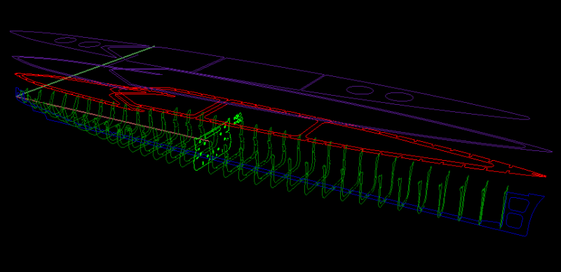

    We have decided to construct a 1:96 scale HMS Hood to use the big gun internals from the USS United States. At ~110 pounds and 107" long, it will present not only a challenge to build, but also a challenge to transport. I've undertaken the hull design task, which will include a split in the middle to help with transportation. Should my split design not work, we have a 10' trailer lined up for transportation.
    The basic design is done. A little more work and the file will be shipped off for laser cutting.

  12. rcengr
    There will be two back-to-back 1/4" ribs in the center. I have three 1/4" pins to align the halves and 6 bolts to keep it together. The bolts will be sealed by nylon washers. There is a 1/2" tube, sealed by o-rings, at the bottom to pass water. There is a slot at the top, unsealed but above the stern deck level, to pass the CO2 lines, power wires and controls.

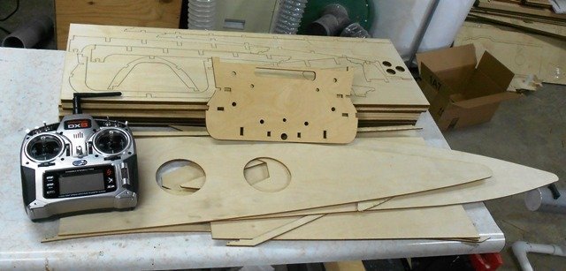

  15. rcengr
    I received the parts from the laser cutter today. The parts alone are weighing in 24 pounds. I even felt a little challenged about what object I should use as a scale reference, since my normal quarter would be lost. The rib in the center is one of middle ribs that will be joined together.
    It's exciting to finally have the parts, unfortunately I don't have time to work on it during the next week.:mad:
