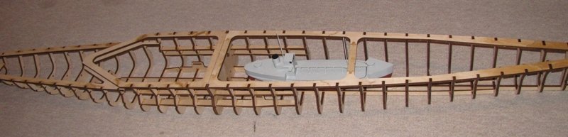

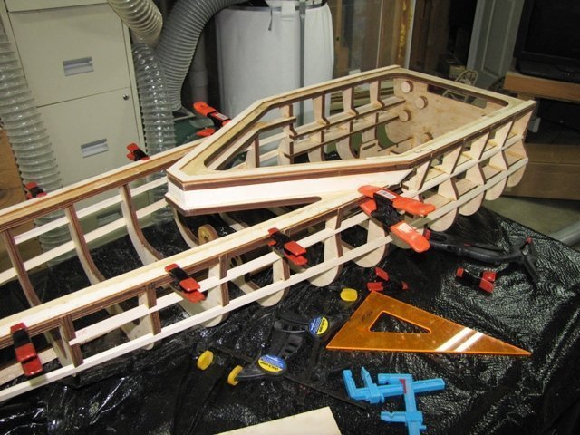

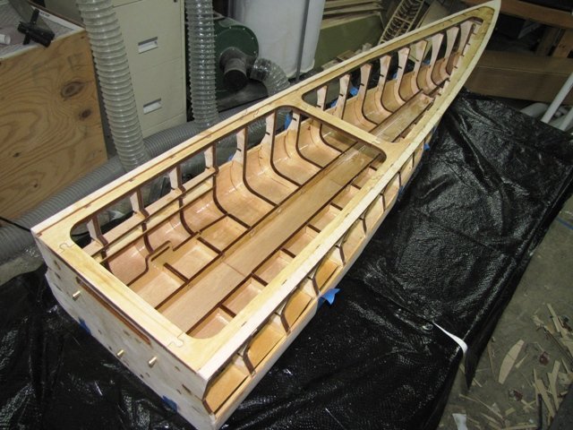

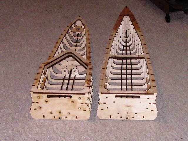

    The ribs are all glued in now.
    A test fit was completed. The halves align very nicely with no gaps. And for today's installment of "HOW BIG is that ship" here's a picture of the Hood with my 1:96 yard oiler. That's right, these are the same scale.

    THAT SHIP IS HUGE!!! I can't wait to see her finished. When do you think you'll finish her?

  4. rcengr

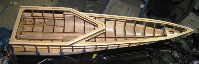

    The deadline for having the Hood battle ready is the 27th of September. Of course I'm just doing the hull, so I need to get it done and on to Matt to install the internals. Hopefully I'll get my part done in the next week.

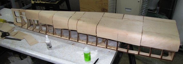

    This weekend I got the stringers installed and the hatch frames on. Well, almost all the stringers. I only had 24' of stringer material on hand, I have go buy another 8' to finish it.
    I have the bow sheeted. Normally at this point I would be done sheeting the ship.
    The inside looks a little better. After a little trimming I coated the interior with epoxy to seal it and reinforce the glue joints holding on the plywood.

    Sheeting it is one of the tasks for next guy. I have no desire to try and wrap 1/8" balsa around that bulge o_O

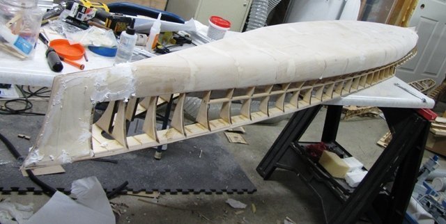

    I was able to get the stern sheeted and sealed tonight. It took 4 pumps of West Systems epoxy just to seal the inside!

    Well the worst part is over... sanding. I glued in blocks of poplar to fill in the first bays at the bow and stern. I did the rough sanding of the blocks with a 4 1/2" angle grinder and an 80 grit pad. This is the first time I have used the angle grinder and not only did it take off the wood fast, it was surprising easy to control with just one hand. Following up with a palm sander with 60 grit got the finer shaping done. All in all, it was about 3 hours to complete the sanding. And now I have this funny little tingle in my hands that comes from holding a palm sander for two hours.
    When I assembled the hull, the halves matched very well, so just a little sanding was needed to get the final shape. That was a bit of a relief for me, I was worried that I would need to do some major blending.
    Tomorrow I plan to sand off the final filler and fiberglass the bottom.
