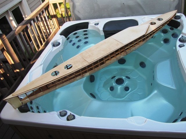

    Hmm... I may have to fill up the hull with water to see how much weight a ballast tank would save. Because it is a deep hull, the available volume may be bigger than I've seen in other ships.

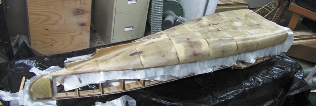

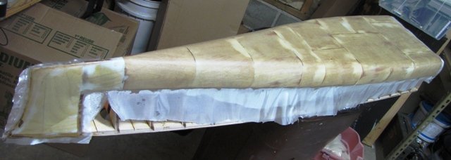

    Good progress was made again tonight. I just hope the epoxy holds out, the resin can is feeling pretty light.

    That fiberglass job looks really good! I can imagine why the resin can is feeling light.:)

    I was able to finish the waterproofing of the hull and the decks. As I let the pump retract from what I knew was the last epoxy I needed, I heard it suck in air. Just made it!

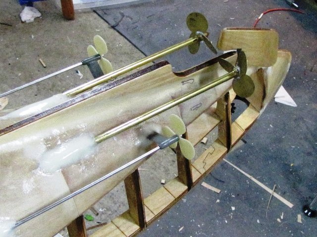

    I was able to get the rudder and shafts installed. I still need to add the braces to the main shaft, but I was too beat to get it done tonight. The motors are mounted and ESCs wired, so once the shafts are done I'll be able to run propulsion tests.
