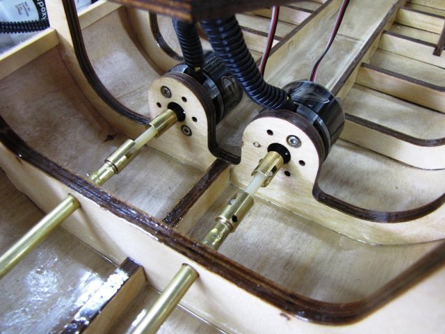

    Motors and dog bones.

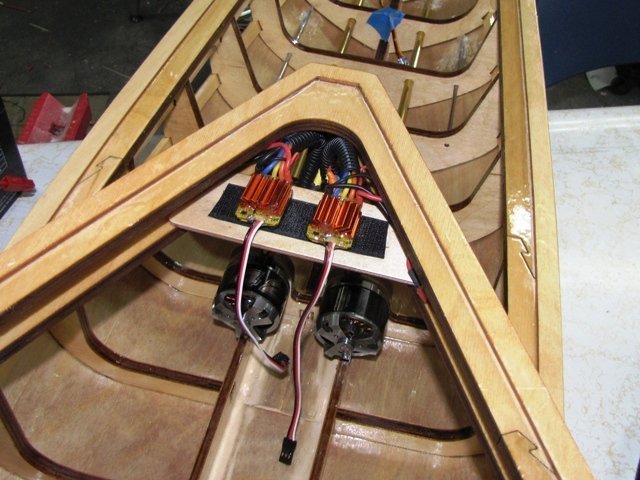

    ESC installation. I took advantage of the 01 level to build a tray for the ESCs, keeping them out the water in everything except a sink.

  6. GregMcFadden
    which esc's are you using?

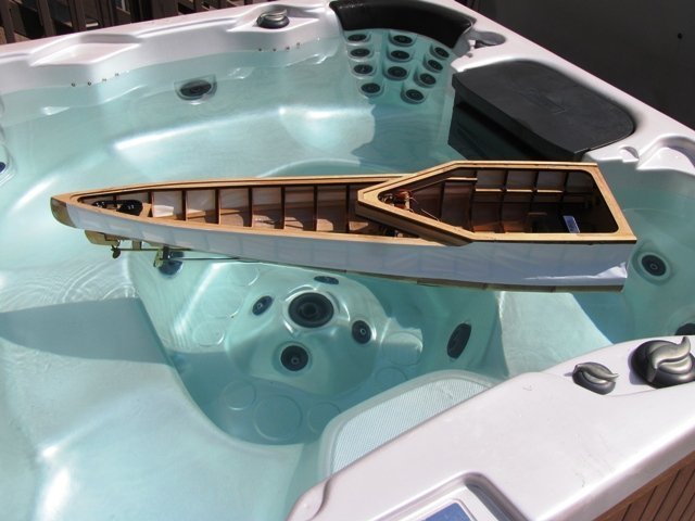

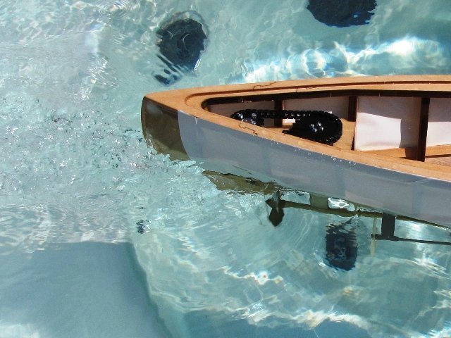

    With everything hooked up, I took it out to the test basin. The motors draw 14.5 amps, 85 watts each at full throttle. A little more than I was expecting, but within the capability of all the components. Plus I don't think full throttle will be needed to make speed.
    Motors: NTM Propdrive 42-38 750Kv brushless
    ESCs: Trackstar 18 brushless
    Battery: 6 volt SLA. 12 AHr for tests, 2x 36 AHr in battle configuration
    Props: 2" 25 pitch 3-blade
    When you can't fit the whole ship in, just put in half of it. The float test was successful, absolutely no water coming in around the shafts and other penetrations in the stern. I had a little water coming in from somewhere, maybe through the stuffing tubes or maybe from the tape I used to cover the sides temporarily. I'm going to add an epoxy fillet to reinforce the joint between the center rib and bottom sheeting just in case.
    Even at 1/2 throttle, and only one prop turning, a rooster tail is starting to form.

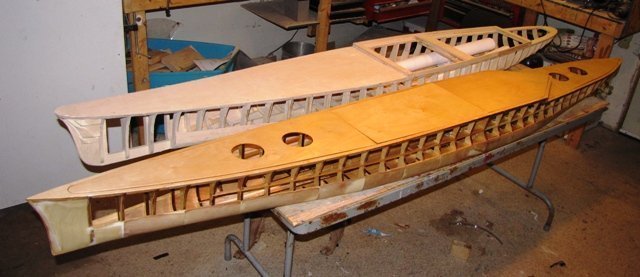

    The MIGHTY Hood meets USS Arkansas. USS Arkansas swallowed whole.
    The MIGHTY Hood meets the King of Barts. No shots were fired, but the British sternly admonished the French to scuttle while they had a chance.

  10. Beaver
    Man, I didn't realize how small the USS Arkansas was until I saw it in the Hood. :)
    Beaver

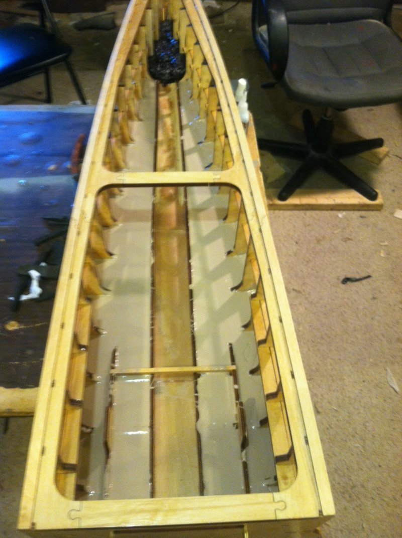

    I had some more photos of what I used for the filler underneath the self leveler, but the files became corrupted. I used 3/8" deep foam tiles cut to fit between the ribs, and the water channeling, I sealed them with epoxy, then I poured 3/16" thick layer of self leveler for the first layer of the water channeling. Which took 67 fluid ounces. Normally I make progressive layers lateral to the main channel, but time is short before the September battle, so that will be saved for a refit. the last photo shows a good majority of the main super structure, the boat deck level is not shown, but it has been cut out, now back to working on superstructure/internals/armor/etc.

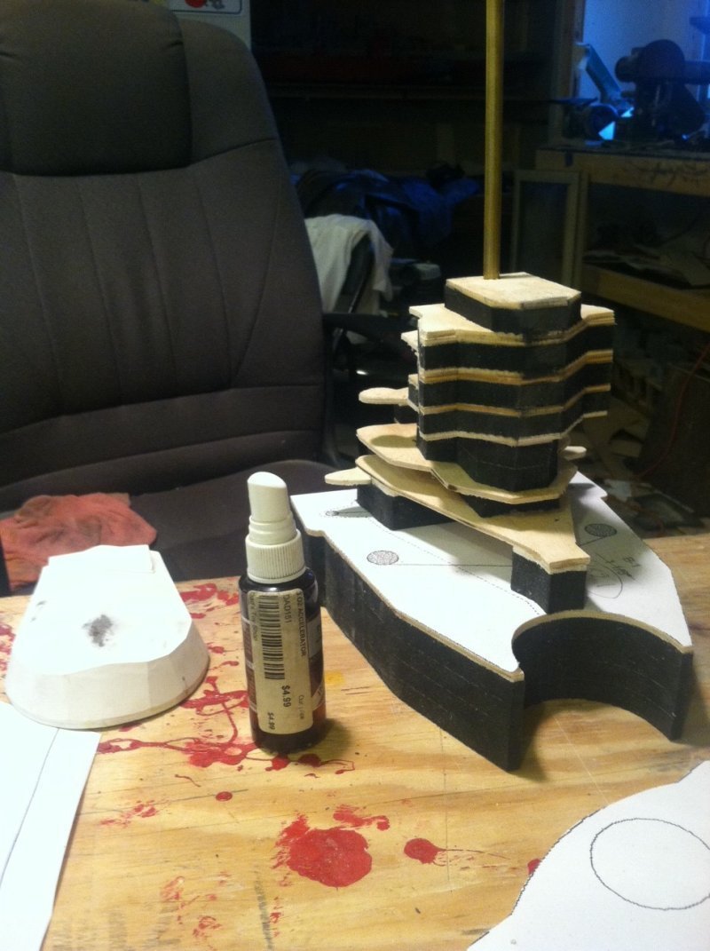

    What is the black material between the deck levels?
  18. Kun2112
    I believe that is the black foam floor tiles used for weight rooms, to sit fitness machines on, and in workplace ergonomics for when workers have to stand in a certain area for extended periods. It is a very rugged and dense closed-cell foam that is Matt's go-to material for rapid and durable superstructure construction.
  19. Tugboat
    Does he cut it with a hot wire cutter? It looks really well aligned between each layer.
  20. Kun2112
    I think he just glues the layers of foam together, glues that to the plywood with the outline, and takes it over to the bandsaw--viola, er violin, um wahla!
