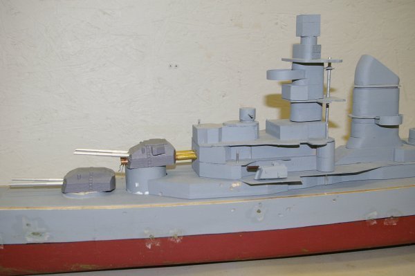

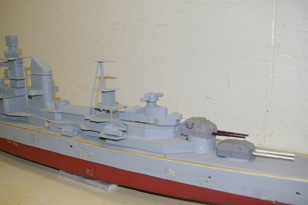

    How do you have the guns through the SS? Is that hard to do? Can you put them in the sturn that way or with that set up, would it be better in the bow? what do you thing?
  19. froggyfrenchman
    I actually had the twin cannons in the stern to begin with. But I couldn't make them fit the way I wanted the morning before the Denmark Straits battle.
    So I pulled them out, and mounted them in the bow, where there was more room.
    It worked out just fine in that case, as I was able to run around and chase the two British capitalships with my bow cannons.
    But there is no doubt that a pair of stern cannons would be not only more useful, but also more deadly.
    Capitalships will always try to run down cruisers, and bring sidemounts into play. So stern cannons would be best.
    I mounted my cannons in the superstructure like that so that I could hide the barrels under the turret covers. I always try to sleeve the barrels
    with the rubber hose to protect them from dings that will cause ammo jams. But I do not like the looks of the barrels after sleeving them.
    So I opted to simply hide the barrels in the superstructure, where they are already protected.
    So I like the looks of the ship up-close.
