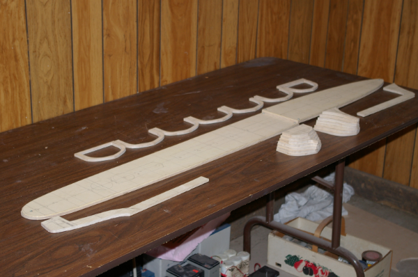

    All ribs are drawn on wood.
    All but the last 5 are cut out.
    Aren't I a stinker??

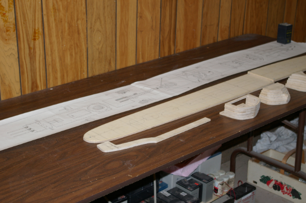

    Mogador sub-deck, deck, with all ribs, bow and stern profiles.
    Notice the file folder rib profiles in background.

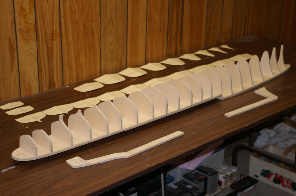

    Rib centers are being cut out.
    I am using 1/4" ribs spaced just over 2" apart.
    1/4" sub-deck. 1/8" main deck. 1/4" keel in bow, and stern.

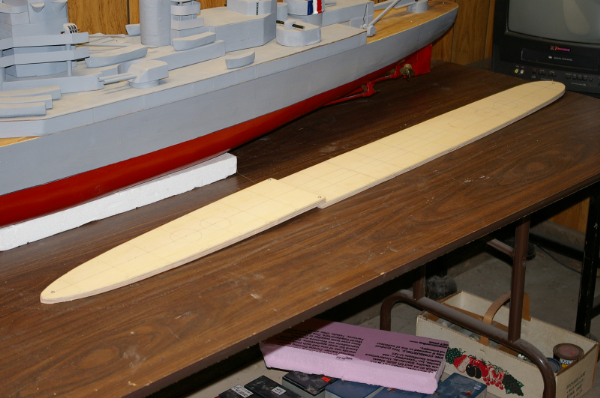

    Mogador coming along nicely, with her probable new running mate.
    Both would be great escorts for the Strasbourg.
