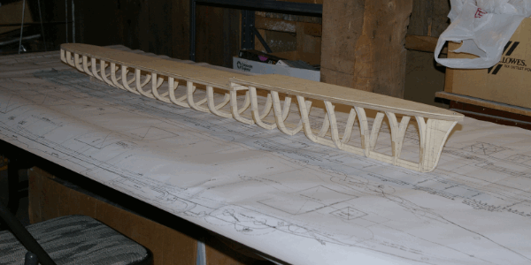

    All of the ribs are in place from the step deck-forward, including the bow
    profile. I have half of the lower deck rib centers cut, and in place (but not
    glued), and hope to have the last 7 ribs and stern profile shaped and fitted
    so that I can have the entire skeleton glued up this coming week-end.
    I will try to post new photos then.

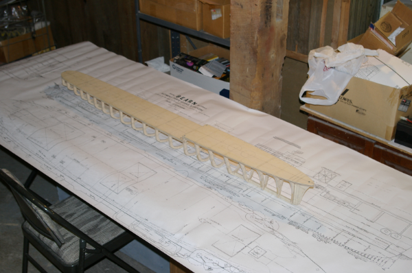

    I have made a little progress on the Mogador.
    All the ribs are glued in place. Bow profile is in place, but not glued yet.
    I will try to get the stern profile fitted next session, and finish shaping the skeleton for bottom sheeting.
    I plan to use 1/64" ply on the bottom.
    I will try to post some photos in the next couple of days.
    Mogador sitting on top of our new Bearn plans.
    All ribs in place, with bow, and stern profiles.

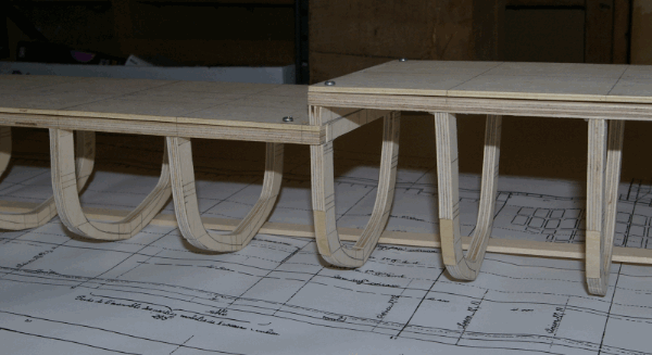

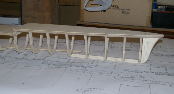

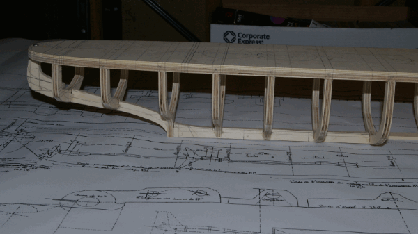

    Some close-ups of the bow, and stern profiles, and the step-deck.

    I was able to cut out the center of the decks, and glue the outer edge in place this past weekend. The entire hull is shaped, and ready for bottom sheeting.
