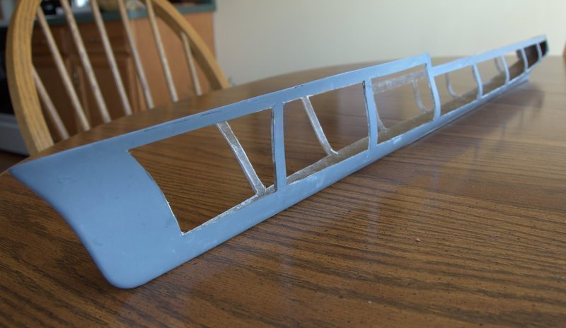

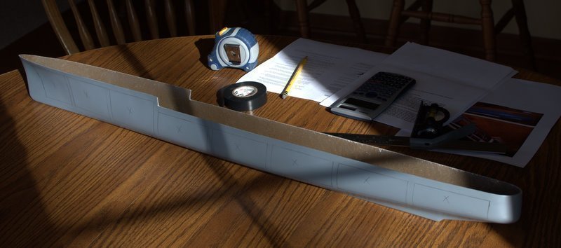

    Laid out the hull panels with 3/8" ribs, 85% open space, 2" from bow, 1" from stern:
    Cut the panels using a Dremel with a very nice wheel -- actually a diamond cutting wheel that I had no idea that they made. It's very thin, and kept the dust to a minimum. Not too cheap ($15), but I've always managed to chew through the stone wheels pretty fast. Didn't seem to bother this wheel at all, like a knife through butter.

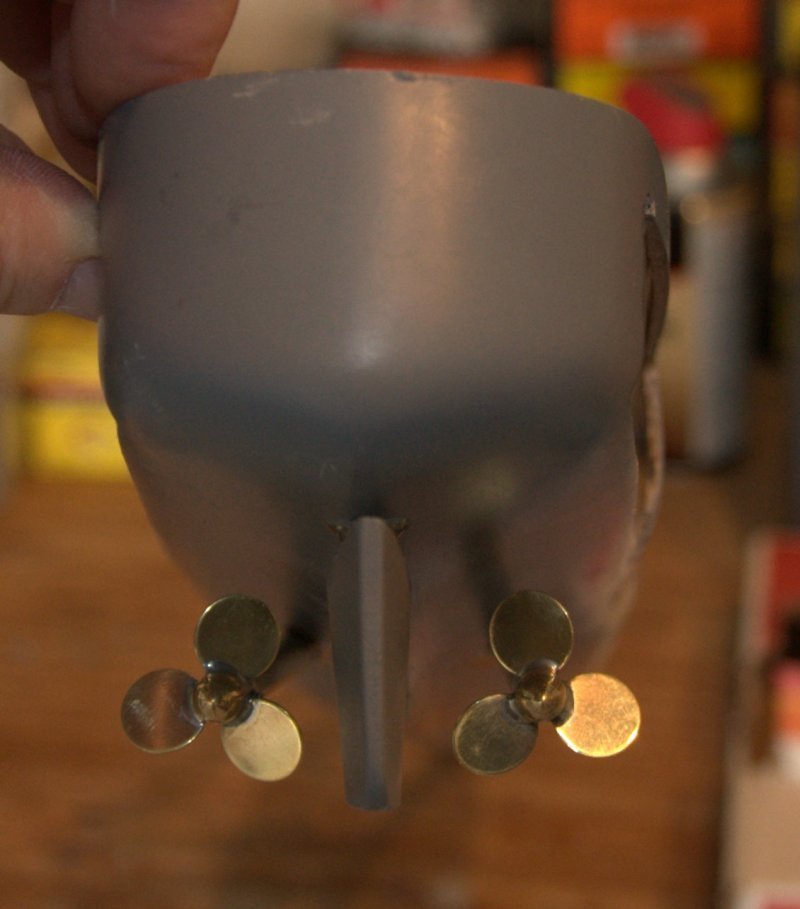

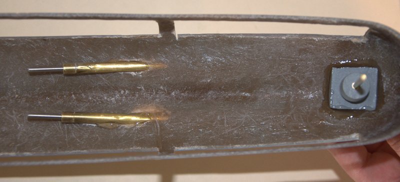

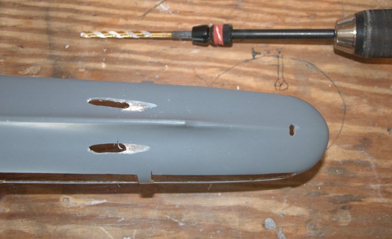

    Rudder & screws last week.

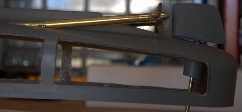

    Drilled the slots for the stuffing tubes. Got them a little longer with a knife. Symmetry is hard. So is centering the rudder post hole, apparently.
    Expoxied in the tubes & rudder post. Not the best alignment. Apparently parallel is hard too.

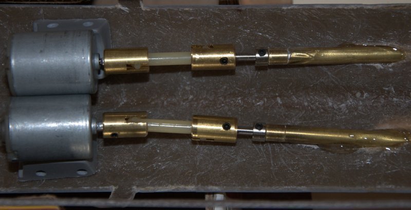

    Motor locations, not yet glued in, just sitting there. They spin well.
    Later cut down the rudder post and attached the tiller arm.
    And from the stern. Looks like it just might work.

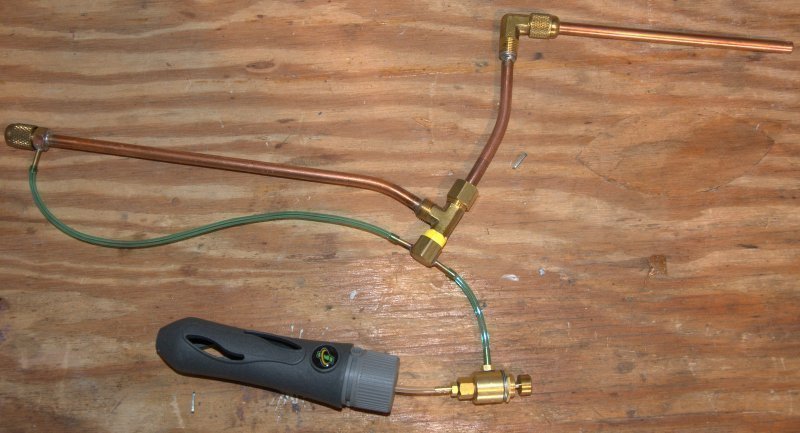

    My son has been dying to try the BC cannon since the regulator came in last week. We're a ways off from mounting it, but it was a good idea to try it out.
    The regulator is the same one from Genuine Innovations that I saw on Steve Tyng's build (thanks!) They offer it on their website, but don't list a price and had to call to order. The regulator, cap, and three CO2 cartridges in kit were $55 + $10 s/h.
    The regulator is advertised to be adjustable from 20 to 150 psi. I need to get a gauge to check the pressure, but fully screwed down is supposedly the top end.
    Anyway, after fixing a blown off hose with a zip tie and some trial and error, we got it firing well. Very cool.

    looking really nice and clean, quick question what is that gray thing coming off the push button, this is the 3rd one Ive seen on post and i heard you saying regulator and gauge so what is it?
  12. NickMyers
    It is a composite regulator and 'cup' for holding 16g or similar size co2 cartridges. The regulators job is to take the full pressure gas inside a co2 source (cartridge or bottle) and drop it to 150psi or less to create the 'low pressure' gas supply for the guns. The 'cup' (part that looks like a handle) is for holding the small co2 cartridges in place.
    http://www.genuineinnovations.com/

    The regulator (spring loaded gray cap), the dark gray cup, and three CO2 cartridges are part of kit #32100 from www.genuineinnovations.com. Also comes with a very small valve (that I could not find a good use for). Need to call to order, can't do it online.
    Yes, the CO2 does run out fast. Pretty much wasted the first two cartridges due to leaks from the 1/16" barb connection within the gray cap; line blew off immediately one time. And this was their supplied line. Needed a small zip tie to keep the line connected to it, then it held fine. All the connections will get zip tied eventually.
    On the third try things went much better, though we still lost some gas and didn't get out a full count of 50 BBs. Need to get more CO2 to verify, though others have posted and said it will go the distance. This was our first time ever messing with one of these cannons. I don't think it's going to be a very forgiving setup (just barely enough gas), but we'll see how much better we get at it...

    I don't know if your shafts are resined in permanently yet, but you really should get the props as close together as possible. Almost touching is perfect. If the shafts aren't paralell, a little bit of toe-in is ok (the motors end are further apart than the prop end of the shaft). Get the props as close to the rudder as possible. Some people even grind down the hub to get a little bit more. Might not go that far, but a little closer wouldn't hurt. Might not seem like a huge deal, but with a very narrow boat you're fighting a bit of an uphill battle with turning to begin with. Speed is awesome, but you might have to turn at some point ;)

    Yep, the shafts are in for good. In truth, I would have liked to get things in tighter and straighter. But full disclosure, I was trying to knock out some progress before leaving on a trip for work. Shoulda posted pics, THEN glued. Lesson learned here...

  20. SteveT44
    To all interested in this regulator.
    It uses 16G unthreaded cartridges. The advertising for it says it comes with a "Multicup" that will take 12 or 16g cartridges. This is not true, only 16G will work as is. I have successfully used 12G in this reg using a spacer at the bottom of the cup.
    On mine, I was getting excessive CO2 leakage after the first couple of cartridges were run through it. The fix was to replace the hard rubber cartridge O-ring with a softer silicone one. No leaks after that.
    When loading a cartridge, a quick final twist when puncturing the seal will minimize leakage.
