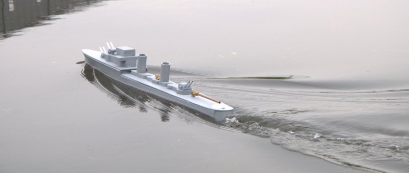

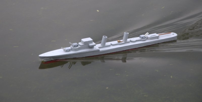

  8. NASAAN101
    She's looking great.
    Nikkie
    I agree with Nikki. Fine looking boat. I would say, angle the gun down a few degrees, but that's a matter of taste :)

    Thank you, gents. As for the range... I'm not sure. The BBs skip across the pond pretty well -- that cannon is nearly level. I think I agree that we could stand to angle it down a bit, to maybe try for the below-waterline hits. I think that will be our next adjustment...
  13. CURT
    Beautiful. Great job!
  14. Tugboat
    I just looked at the pics again. FINE looking boat on the water. You ought to upload the pics of her driving around to the folder for the pics you see when you log in.
