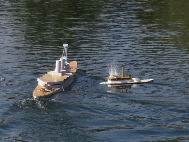

    The ship in question is HSwMS Gustav V. James wins a cookie, Bork! Bork! Bork!

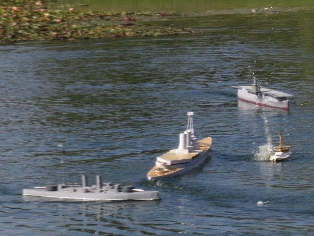

    Arkansas got some shots in on all opposing captains, but due to having to clear the breakwater, no dramatic splash shots. I was busy running her and didn't get many pictures, but I know a lot were taken, and should be uploaded in a few days.

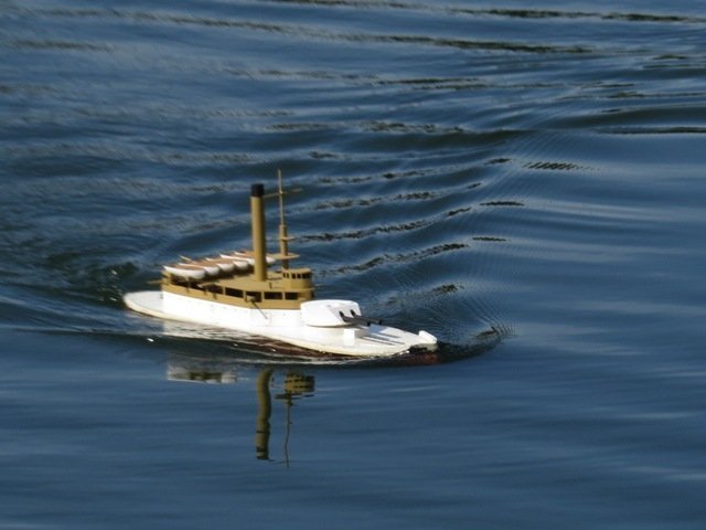

    After Action Report.
    Fire Control: Due to the low aspect ratio of the hull and the adjustment to the magazine/breech inlet angle to accommodate the lack of hull height, the bow cannot be tipped down after loading or Starboard barrel will spurt five or six rounds the first time it is fired. Breech work required. Addendum: Consider modification of breakwater to increase barrel depression options.
    Damage Control: Under no circumstances should the Arkansas put to sea if there are any questions about the pump. Ever. (Follow-up to be posted at a later date)
    Gunnery: Several opportunities missed due to limited firing arc. Suggest R&D focus on upgrading capabilities to add rotation and depression control for the main guns.

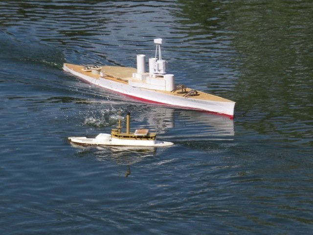

    Maneuvering: Ship was out-maneuvered by HMS Hood. Speed of opponent made up for larger turning radius. Resume research on decreasing turning radius.
    Magazine: Shells expended before powder stores exhausted. Rectify at earliest opportunity.
    Hull: Reenforce deck two to deck three joint. Windows allowed bow wakes and prop wash to enter hull. Deck three was removed in last-man-standing event.
    Final Analysis: Ship performed admirably. A few key upgrades will make for a very formidable combatant in its intended role.

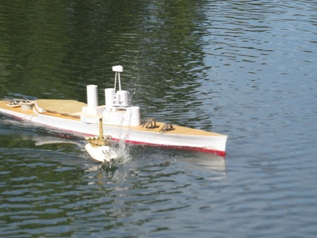

    Update: The Arkansas did have two hits from Saturday's battle. One 1/4" the hit just below the window from the Hood that did not penetrate and one BB hit below the waterline from the Mogador that punched through. Sunday, the Tashkent got another below window hit that did not penetrate. Above decks was a different story: Two lifeboats were shot off, one six pounder's barrel was removed from its soldered mount, the smokestack was hit several times and almost lost (it was even hit through the deck two "windows"), one of the googly eyes was hit on the turret, the pilothouse was hit, and the deck two splinter shield took a through and through. Most spectacularly, on Sunday, deck three was removed from deck two. Only the fishing line in place to prevent the secondaries from becoming lost that was glued to the bottom of deck three combined with the magnets holding the secondaries in place prevented the loss.
