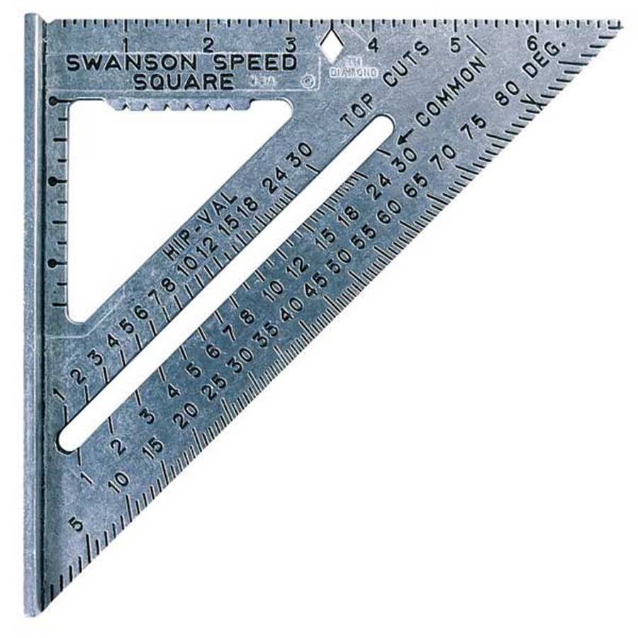

  8. thegeek
    Speed square?

  14. jstod
    Ah I have a speed square. Haha it's helpful but not so much with bulges and curves.
