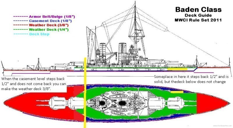

    Here is a list of ships with the "MWCI" deck layouts in color. This list will grow as more are completed and verified to be correct. Click on the links below each pic for full size. This is being tested to see if folks like it or not. If so, maybe we can get this stickied and also ghosted into a couple of places.
    If you would like to see a ship added, just reply here.
    Any Casements that are located either on top of the Casement Deck (Blue Line) or directly underneath the 1/4" Weather Deck (Green Line) must have the flat areas made penatrable IAW MWCI Contruction Rules.

    Germany
    Baden Class
    Click here for full size

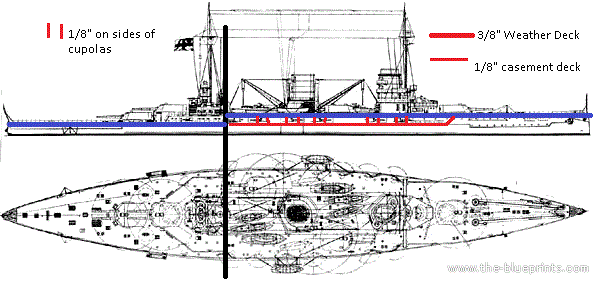

    Moltke Class Disclaimer: This drawing has not been verified.

  3. jch72
    jch72 Active Member
    449
    Excellent markup on the larger drawings.
    The only thing I disagree with is the casemate deck and 1/4" deck actually should stop 1 gun forward from where they do in the drawing.
    On the Nagato the bulge doesn't cover the gunwale up on the back two sets of casemate guns so the area between them is inset more than 1/2" from the gunwale. This is the area just aft of the wierd sloping step down area on the bulge which isn't represented in this particular line drawing.
    And on the Baden I'm not sure exactly where the 1/2" inset from the gunwale would start, but it looks to me like everything aft of the second to last casemate gun should be hard area.
    Great idea to improve the drawings, Mr. Potato :) I'm sure they will be of use and probably be incorporated into the rulesets at some point in the future.

  5. Bob
    Moltke/Goben/Yavuz is pretty easy. On the Strike hull the center casements are not modeled. You have to cut your hull back to install them. Or go without them and have more penitrible area. The little armor belt in the bow is not modeled either, but it's so small on the real ship in our scale I don't think it would be more than a small bump. Still if you want to add the stringer there should be a bump in the balsa. On my Moltke I put the casements in but left the belt out. Backing it with plywood would take up space I need for my bottle and regulator. Unlike the Baden the casements kind of sit inside the hull a 1/8" overhang with 1/8" below the cupola.
    Opps that big line for the 3/8" weather deck should have been blue.
  6. Bob
    Nope, on Moltke the green area on your photo can be red. You can't go over 1/2" of stringers/decks in one verticle plain. The 3/8" weather deck and 1/8" casement deck get you to 1/2". More solid area for you.

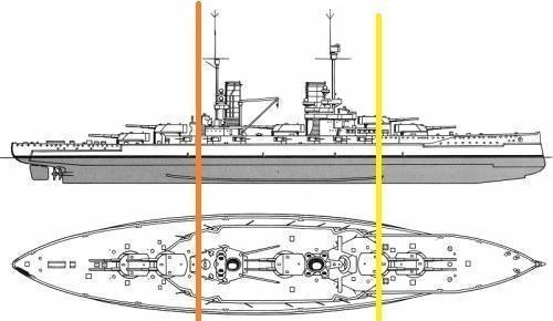

  18. NickMyers
    Can anyone confirm that the Konig and Kaiser classes are affected in the same manner as the Bayern class?
  19. jadfer
    yes they are, all casement ships are affected if I am not mistaken but not all have a diagram.
  20. Bob
    Well that depends...
    I don't have a set of prints, the best I can do is the below. If the casements go back 1/2" past the edge of the deck at the yellow line, then the deck drops below the casements and they are solid. If the casements are less than 1/2" then they are open and the level below them is 1/8". The orange line is where the deck would drop in this case.
    There is an armor belt on this ship. Note that the belt is the outer line in the top down view. You have to take the 1/2" from the inner line, the edge of the hull.
    Looking at the photos on the BC site, http://www.battlersconnection.com/html/konig.html it's hard to tell too. The first ship looks like they are more than 1/2" back. The 2nd one is tipped too much to see.
