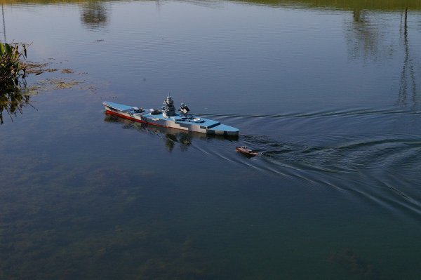

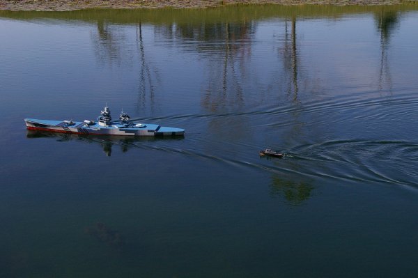

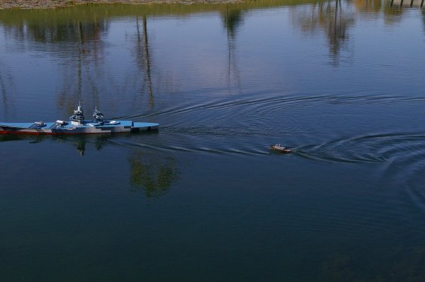

  14. froggyfrenchman
    Dustin's new Richelieu class battleship, and Mark's new tugboat at the Xenia, Ohio battle.
  15. NickMyers
    Wow, that certainly gives a sense of proportion there. You could almost mount the tug on the deck of the Richelieu and say it was the captain's launch...
    OO! OO! Put it on a pair of brackets on deck, with a 100-weight fishling line reel attached... Richie sinks, the tug drags it home!!!
