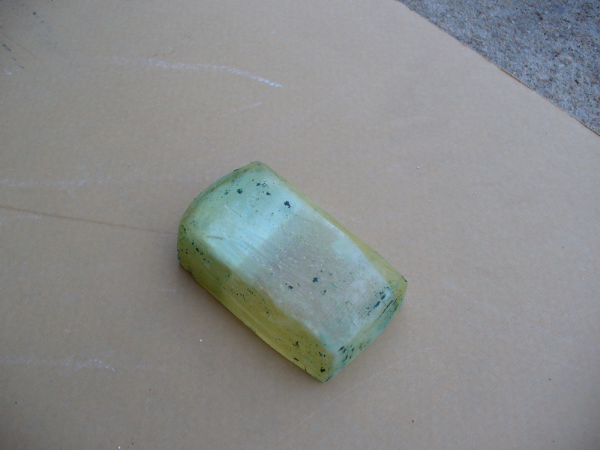

    The first pic is the outer and inner section of the mold.

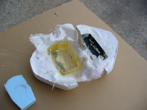

    The second pic shows the inner mold pulled out of the turret.

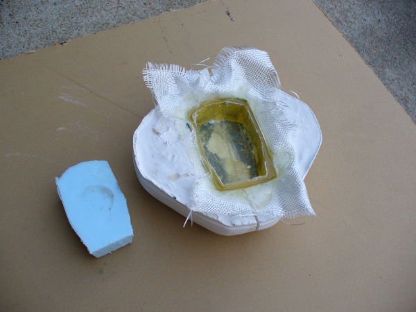

    Pic three shows the turret being pulled from the outer mold.

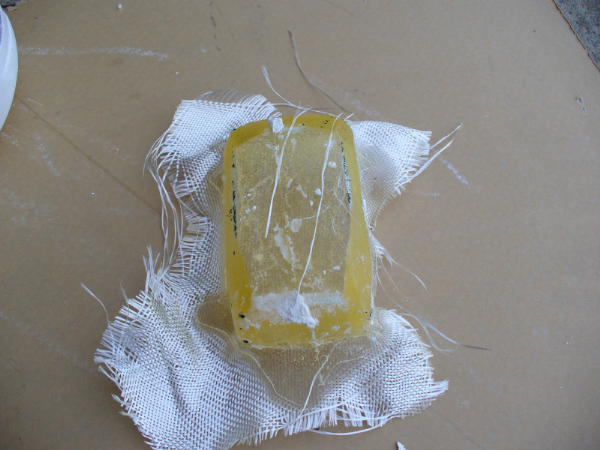

    Pic four is the turret pulled from the mold and ready for cutting.

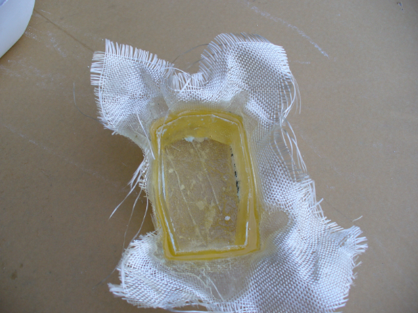

    Pic five is the top view of the raw turret.
    Pic six is a view of the turret from the top. If you take a close look you can see the blue foam that is glued inside so that the turret will float.
    The turrets will be sanded to give them the crisp lines where the armour is welded together.
