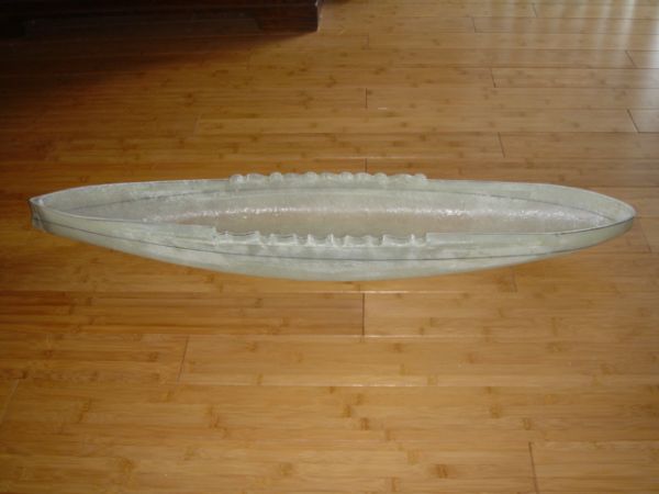

    Hi all
    I just received my VU from Michael in Australia, so its what I will be working on for the next couple of months.

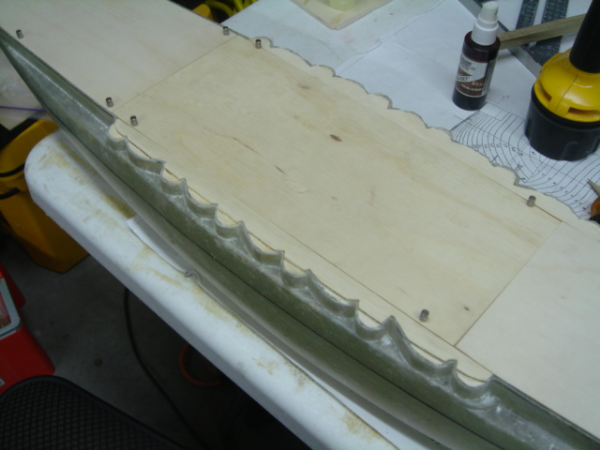

  5. djranier
    Hello all
    Battling is almost over for the year, we have a 1 day scheduled for Dec, but the Roma is about ready, so I have finally started on my PE.
    I cut out and installed the sub and main deck, still needs some clean up work and then the wet systems applied.

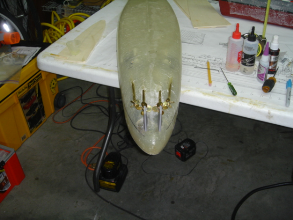

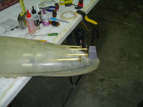

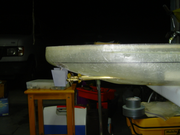

  6. djranier
    I then installed the shafts and rudders. I tried to get the shaft and props as level as possible.

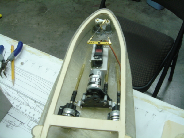

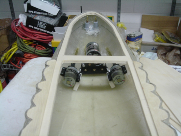

  7. djranier
    I installed the motors and rudder servo and linkages.
  8. djranier
    I'm getting what I wanted on the rudder throw, the starboard needs a little adjusting. The inner rudder is turning about 15 deg more than the outer, should help the stern skid around. Not bad for me, got most of this done in the last 2 days.

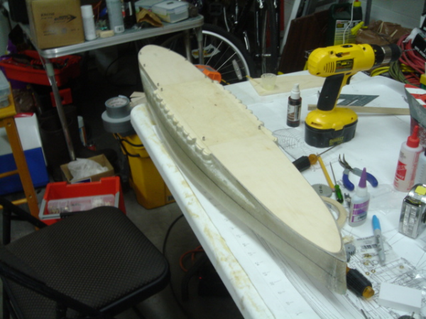

    Here is what I have got done last night and tonight. The side deck above the casemates cutaway, and the stainless hardware to hold the deck on.
    Maindeck on.
    Stainless hardware.

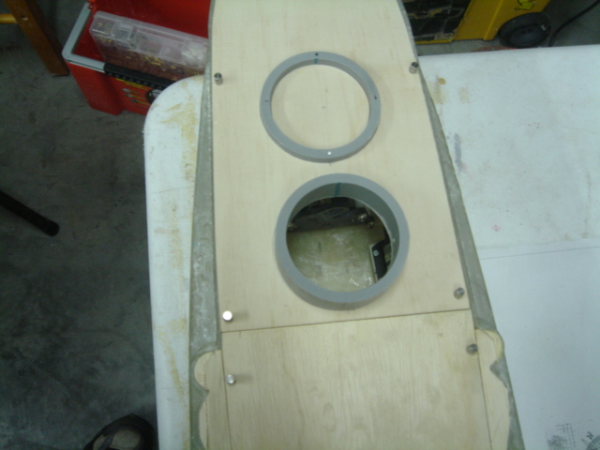

    Well I got a little bit more done, added turret rings. Curt asked about clearance for the stern guns.
    Here is a shot from the Stern towards the Bow.
    And a starboard forward side shot.
