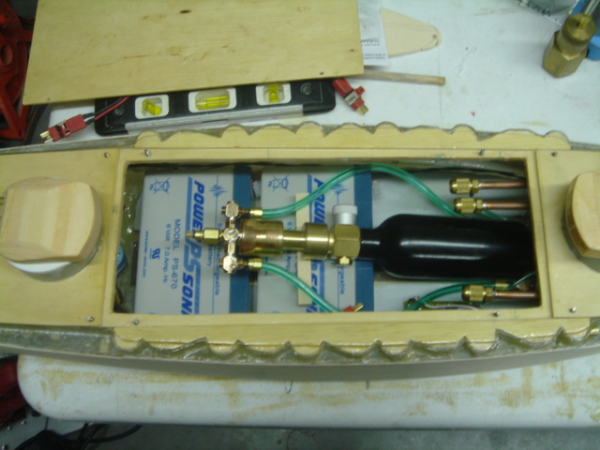

    Right now I'm planning on just 2, 7 amp, they sit right in the middle section, towards the stern, the CO2 bottle sits with the base right between the CO2 connectors coming off the accumulator tanks towards the forward side.
    I checked the balance, and right now with everything in it, it is just about 3/8 in off towards the stern, but I still have a few electronics to mount in the front, and the larger part of the superstructure is also towards the forward section, so it should be very close on balance.
    I went and added the stuff to the center so that you can see how it will be layed out. I need to cut the hose down some also.
  2. bb26
    Ahhh now i see how it fits. the earlier picture I could not guage the depth from where the regulator would sit and the batteries. Well done.
  3. djranier
    Thanks, so far I'm very happy with it myself. I tried from the beginning to get it to lay out this way. I only wanted to have to remove the 4 nuts to remove the center section to be able to service everything between sorties.
    The guns have worked out beyond expectations also, they align right past the deck edge, which is also what I was aiming for.
