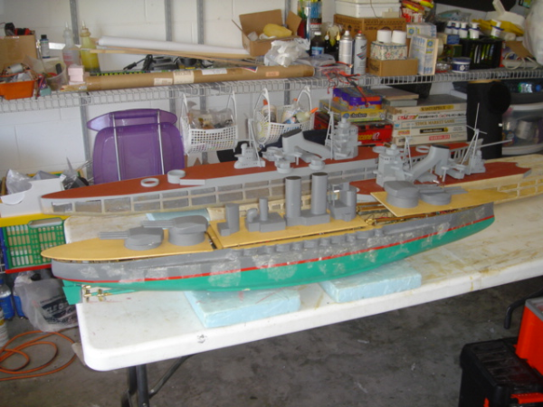

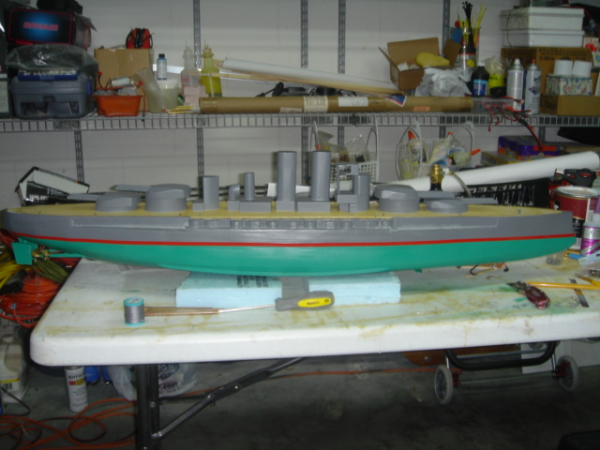

    Well all here she is, the mighty PE, baddest class 4 afloat.
    With all the high tech improvements that I could think of.
    1. Concrete patch water channeling, really improved the stability with the weight down low.
    2. Differential rudder steering, tight turns at high speed with no loss of speed in the turn, very nice.
    3. Gun control, independant firing of the tripple cannons, or all at once.
    4. Light weight scrap, missle, aircraft modeling resin superstructure, very strong.
    5. 2 Secret improvements. Cannot discuss at this time, top secret.
    Well here she is, in all her glory. Next on the list the IJN Kumano starting week after next.

    Very Nice David. As allways your end product looks clean and ready to chew up the Enemy.
  4. bb26
    Absolutely fantastic. Well done.
  5. Gascan
    How did you set up the differential steering to work? How much does it help?
    Looks good, I like it. Especially the identical barrels, I can't tell which ones are armed.

    Over time I can add the 2 masts, and 2 gun directors, but besides that all its really missing are all the search light platforms, and the boat storage rails. I have no plans on adding those.
    I see that your working cannons are in B turret. Very sneaky.
  11. djranier
    Well that was my plan, they look like they will hit a hull at 14 to 15 inches, and waterline at about 18. I plan on just doing a high speed run at the target, and then turns to avoid getting hit. I will have to see how well it works. First battle is next weekend. Most people will not expect it I think. She turns at just about her lenght, at max speed with no drop off in speed.
