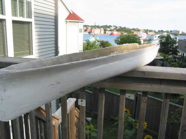

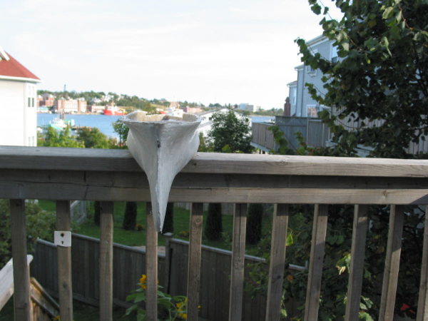

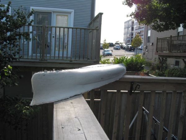

  2. slow_and_ugly
    slow_and_ugly Active Member
    May 29, 2007
    232
    Hi,
    I popped the first hull out of the mold this afternoon. I still need to clean it up, and I probably should have waited before posting the pictures.
    It's not pretty, but it is serviceable. Only a one small void on the outside, although the FG has air bubbles in it. I also missed a couple of spots with the gelcoat. Grey on Grey is hard to deal with. I still have a lot to learn about laying in FG, but the next hull should be better.

  13. Bob Pottle
    Rob,
    The next Renown hull will be better - it takes practice to lay up hulls. It's a nice looking hull. Re the gelcoat I've been applying two coats to my molds to make sure it's thick enough. I apply the second coat after 24hrs, then glass after another 24.
