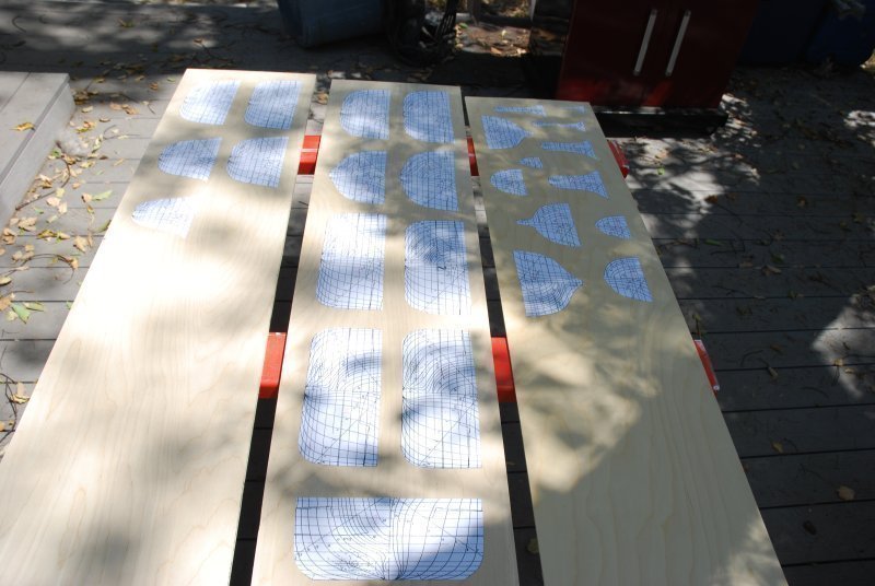

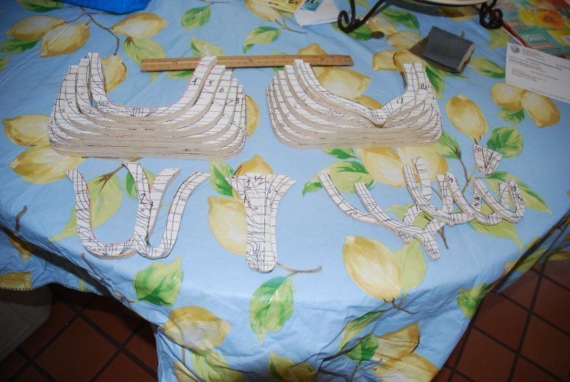

    The wood has arived the tools are prepped. Time to get to work. This is my Bismarck wooden hull build. The following pics are where I am so far.:cool:
    Ribs prepped for cutting.
  2. absolutek
    RE: My Bismark build You're going to waste a lot of wood if you lay out your templates like that. Try fitting some of the smaller ones inside the larger ones. Just a thought.
  3. jstod
    ooopss to late o_O Also the alot of the smaller ribs are on smaller 1/8" wood so they cant go into the bigger ribs which are on 3/8" wood.

    RE: My Bismark build I like the cut outs what tool did you use to cut the ribs out?
  6. jstod
    RE: My Bismark build I started with my craftsmen rotary tool with a multi purpose bit but i burned through it to quickly so i did the second have with a dremel table saw (not sure exactly haha)

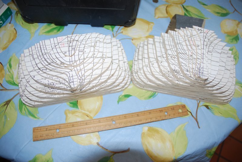

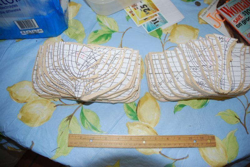

  9. jstod
    After 4.5 -5 hrs of work (watching tv at same time haha) my ribs are sanded down and ready for interior cuts. I am going with a width of 1/2" with some extra left on on the bottom of the aft ribs incase of need.:cool:

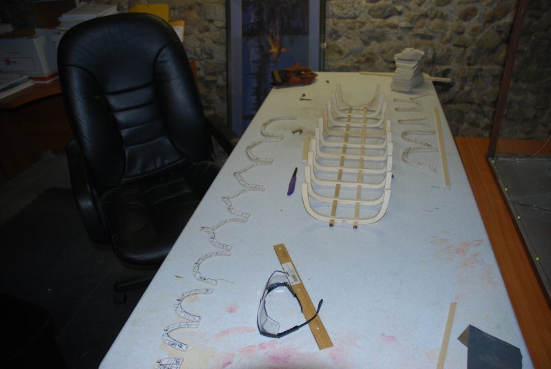

  11. jstod
    and now all the ribs have been cut out completely. the only cuts left to make are the slots for the keels (i am doing a double keel 2" apart for most of the ship then a single for the bow and stern sections) along with a cut in a seclection of the middle ribs for the stringer (not sure if I am going to add it for the initial build or install during a refit if needed)
    Also the double keels have been marked up and spaced properly for intallation.
    Also my Golo kit is in the mail.

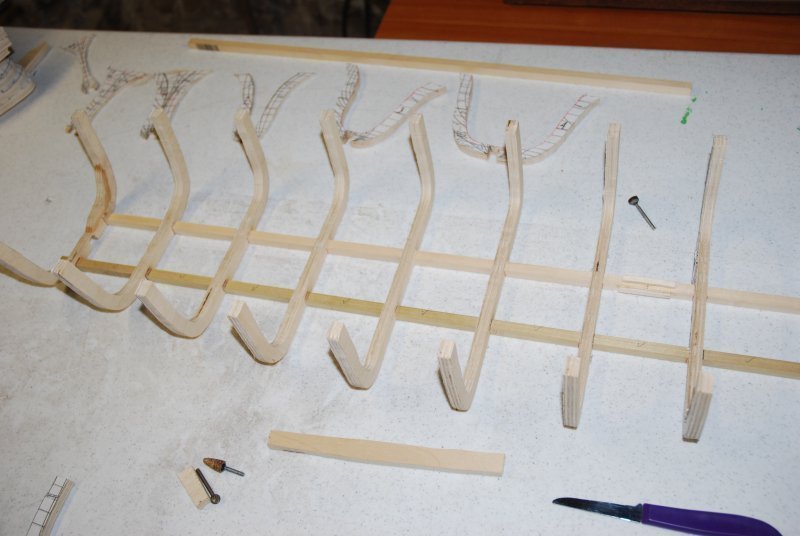

  12. jstod
    So my Golo kit came in today so ofcourse instead of waiting i imediatly opened it up and went to work. Man i gotta tell you it is a breeze to assemble. the only difficulty is some of the pieces need to be sanded a bit to make the fit easier. which isnt hard at all. the intructions very easy to follow so I should have the hull constructed by the end of the weekend.:cool:
    Ok now onto Bismark. I have hit a snag and need opinions of the experts. I need to cut out the slots on each rib for the keel to fit in. what tool is recomended for this? I am afraid to use the table saw i have because the area is pretty small and then the dremel likes to jump suddenly. If i had more wood i would not even be hesitating but as it stands i can replace 4-6 ribs on the wood i have.o_O
    any tricks to make this one easy?

  14. Tugboat
    RE: My Bismark build I use a router table with a 1/4 cutting bit. Makes the job fast and easy. Failing that, a scrollsaw is the next weapon of choice, but you have to cut out each notch individually. Last choice, use your teeth and gnaw gnaw gnaw the notches out :)
  15. jstod
    RE: My Bismark build hahaha i feel the last option would be to just sand it all the way in :p . I ended up useing the saw i have but staying well inside the lines and then sanding them down the last little bit. I have the majority of the ribs notched and sitting on the keel (not glued). I just couldn't wait to see the biz take some sort of shape. Ill get a pic or 2 up later tonight (assuming the website allows me to)

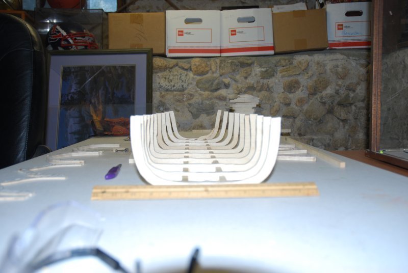

  20. jstod
    Well I can honestly say I am extremly excited now its starting to take shape....sort of :cool:
    none of the ribs are glued in place yet just seeing how it looks and checking the spaceing!:cool:
