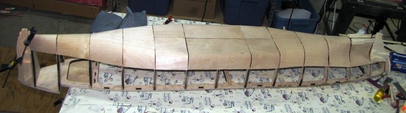

    Below is a picture of my seaplane tender, a 1:96 scale C3 hull. I had to use two pieces crossways in the center because the ply was not wide enough to do it in one piece.

    Ditto what Mark said. I have found that it is easier to divy up in halfs on a section of a ship with a single keel. If using a double keel for the water channel, the ply makes the bottom of the water channel leaving a bit more space inside. With more severe curves, attach at the keel first so the ply won't bunch up on the bend. Below is my Alsace--I tried to do too much with a single piece and sanded through at the corners necessitating some reinforcing ply on the inside. You can tell where I switched to 1/64" by the darker color on one section.
    Keep in mind that you will have to adjust for the thickness the ply will add to the rib profiles. One method is to cut or sand the sections in the impenetrable area to account for the ply, like this:
    The other is to take more ply and cut into strips and add it to the ribs and subdelk like this:
  10. jstod

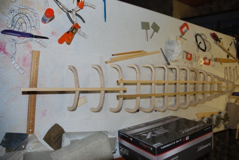

  12. jstod
    ok I appologise for not resizing but the ship is looking a lot like a ship and the editing program isnt working correctly :/
    But here the Tirpitz is:
    I am sorry for the weird angle but I am no photographer haha
    as of now here is what is done:
    Middle ribs all glued in place on the double keel
    bow keel and ribs glued in place
    bow keel now attached to mid secetion .
    For the Wood hull protion what I have left (please chime in if It seems I have forgotten an important part):
    install stuffing tubes to the aft section
    gle aft ribs into place
    glue aft keel to rest of hull
    make deck and sub deck
    fiberglass the bottom
    Once I have installed subdecking and fiberglassed the bottom (which i am not looking forward to bc i hate fiberglass) I plan on removing the middle portions of each of the ribs attached to the double keel portion of the ship and use it as water channeling. Good or bad idea?
    once again all input welcome
    Thanks!!
  13. NickMyers
    looking good.
    removing the middle portions to create the waterchannel is a good idea.
  14. jstod
    Thats what i was thinking when i went with the 2" apart double keel.
