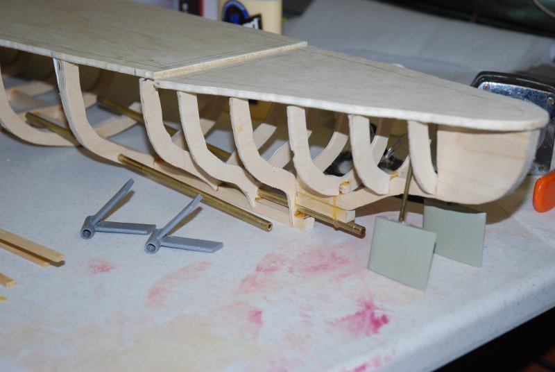

    She is no were near complete but to me she looks pretty :cool:

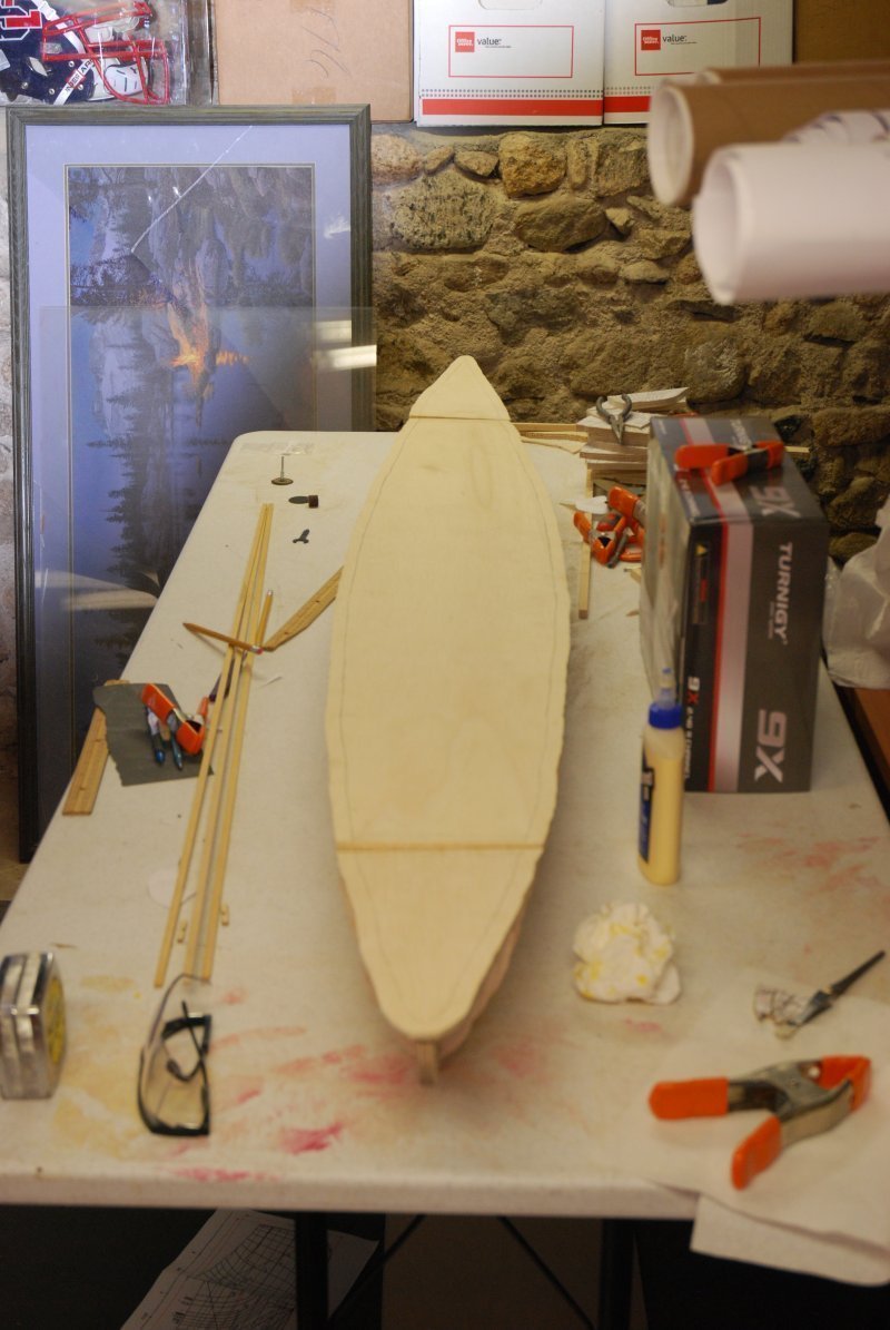

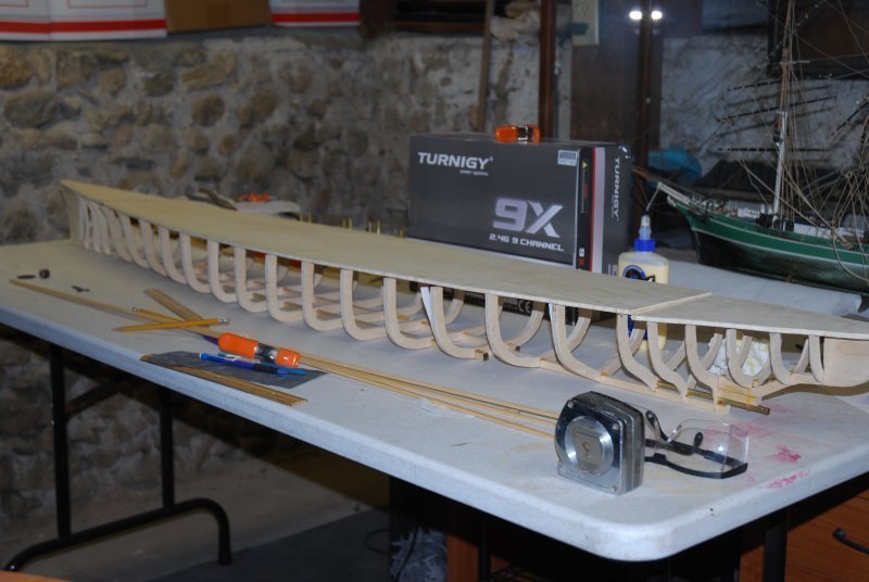

  2. jstod
    Ok so sheeting the bottom of the hull is a real pain in the A$$ well not the actual bottom more so the curves. :pinch: The wood just isnt sitting right. I think I am going to do a hybrid of sheets and planks before i fiberglass it. I plan to use sheets for the flat bottom portions and planks of the same thickness for the curves. This SHOULD save me from frustration all though it will take significantly longer.
    as always thoughts and suggestions are welcome.:cool:
    What thickness (of wood) are you using for planking?
  4. jstod
    Well first I tried to use 1/32 ply and it sorta work but it kept popping off so I started to use 1/64 but after the curve when trying to atach it to both ribs, one being not as wide due to the shape of the hull, it did this not so pretty bend in the middle. So i think I will use 1/32 stuff for the flat bottom portion and then switch over to small strips of the 1/64 stuff for the curve.
    Does this seem like a god plan?
  5. jstod
    Ok so I went down to my ship and started to fiddle with it. I tried another piece of 1/32 on the bottom and curve and this time it worked perfectly. I think I just was working a little to fast last night so it caused the weird bend. We shall see.
  6. NickMyers
    You should consider something besides your stuffing tube carrying the load of the stern there (and anything piled, dropped, etc on the stern) Might be a little overly paranoid, but that's not something you want to be having to rip out down the road.
  7. jstod
    I completely agree with you Nick. It is on my to do list to reinforce it completely. Right now although it looks to be holding up that stern section it really isnt. It is sitting a very very very small fraction above it almost to the point you cant see. The connection is still very weak indeed though. I plan to either fill around the tube with wood filler and then use to pieces of 1/8 birch on either side to add the true support. Or I may just not do the wood filler and just do the support pieces of 1/8" birch.
    Any suggestions?

  9. jstod
    I am actually continueing on with useing the sheets of 1/32 and 1/64 ply. it bends pretty well and I have been useing CA glue with a little bit of tighbond2 to double up on the connection

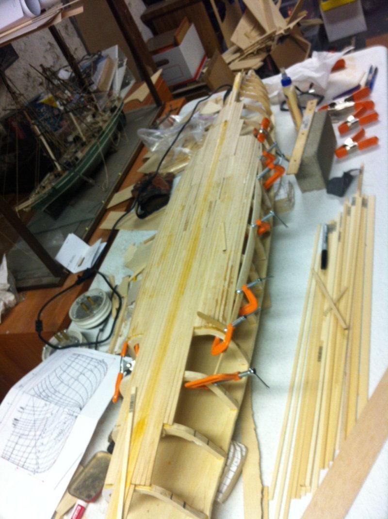

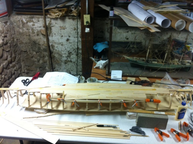

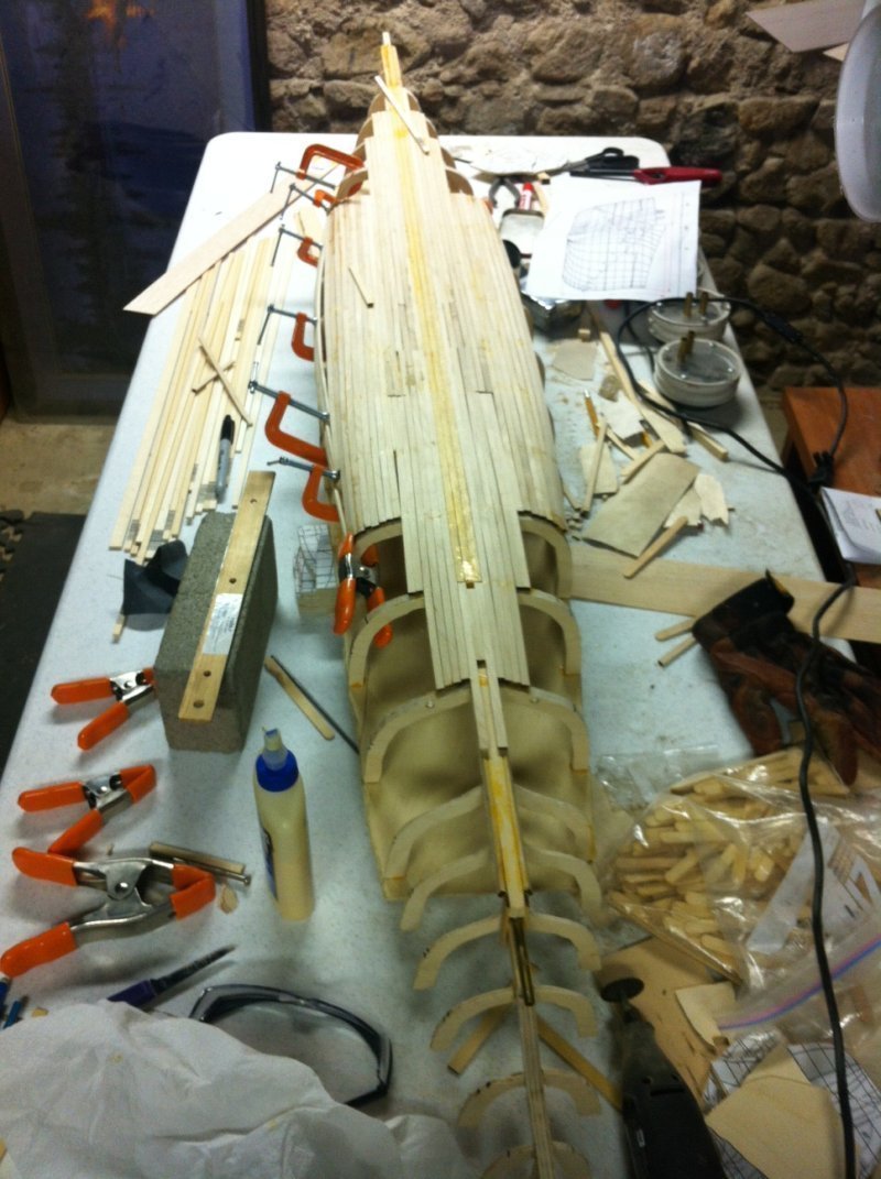

  17. jstod
    Tirpitz is in a holding pattern at the moment. Waiting for construction materials to arrive at the ship yard. Mean while I have a Lutzow recently added to my fleet almost done with her refit/mini overhaul. She is scheduled for sea trials sometime next week if her parts come on time haha.
  18. jstod
    The Planks for the Tirpitz have arrived so construction is going to be back underway tonight after work :) It has been to long sense I was able to get anything done on her.
    Also the Lutzow is just about ready for a float test followed by sea trials after her refit/overhaul Just need to connect all the wires together haha
  19. jstod
    Planking is not hard to do but is time consuming that is for sure. More pictures of the progress to come.
  20. jstod
    Its a slow process but it looks really cool haha
