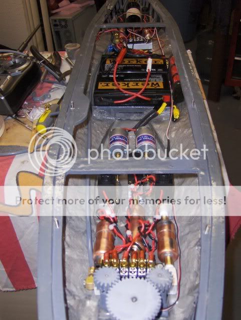

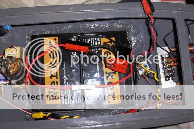

    Hi Fred

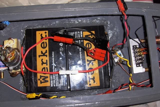

    Do you think it will last 2 complete sorties on just the 12 amps? Or do you guys swap your batteries after every sortie? In the MWC the guys running the SD's, and NC's are using 36 amps. Most of them can just make it 3 sorties on the 36 amps before they run out. So they are using between 24 to 28 amps for the 2 sorties according to how long the battle lasts for.
  3. Powder Monkey
    I should hope so seeing as it is only running my motors and my Guns;)
  4. djranier
    Ok the same thing that they are running, you guys must not move, or pump much, good luck with it.
  5. Powder Monkey

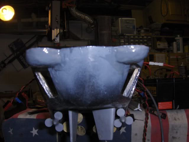

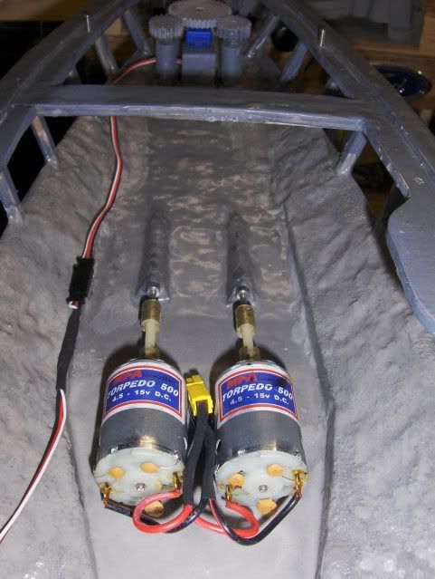

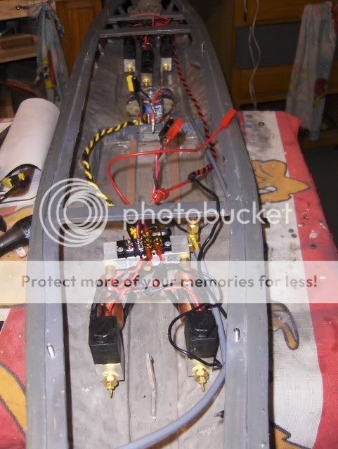

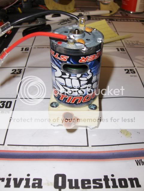

    my pump runs off of a separate 7.2 NiMH 4500 and my Radio off another. you don't see them in the picture because they just came in today . so the 2 6 V 12Ah SLA run in series for 12V only run my 2 Direct MFA COMO Drive 500 Size Motor and my Clippard Solenoids :blink: I should think that will do
  6. SnipeHunter

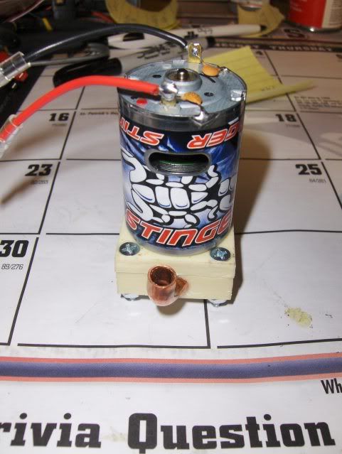

    Any idea what current your drive motors and pump motor draw under load? I wouldn't be surprised if you drive motors have plenty of juice its your pump that I would be concerned about but that really depends on the pump motor. Using something that will pump enough to keep you competitive you'll probably be drawing upwards of 10 amps(possibly closer to 20 I forgot what the stringer draws and a titan draws even more) which would give you less than 30 min run time on the pump battery. 30 min of pump time is on the light side, if you take some damage early in the first sortie that could easily be a problem towards the end of the second sortie when you need your pump the most. Try and get enough capacity to run everything in your boat for an hour that should cover you for a two sortie fleet battle or campaign.

    I run two 12amphr 6volts in parallel for 24. I have gone whole days of battling running 2 550's and a 550 pump. sometimes it won't even take a charge. Messing around in your backyard will reveal these kinds of things. :laugh:
    I wonder if it has anything to do with the fact that it is just one battery. Monk has enough battery onboard for that thing. He just needs a board of chargers...

    PE is much smaller and using the same batteries only I set it up for 6v 24 amps. The ship ran the entire day with battle damage, flooding and still powered through.12 amps may not be enough for a ship like the Sodak especially when the pump begins to draw more amps under load.I:)
  11. rarena
    Monk is running a seperate pump and seperate receiver battery. The only thing drawing will be the motors and they may run more effeciently on 12v than 6v. I'll have him up here to battle and we will drop a meter on it afterward. We'll let everyone know what we get. :plain:
