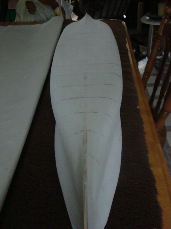

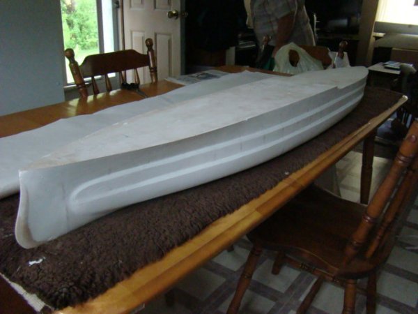

  9. Jay Jennings

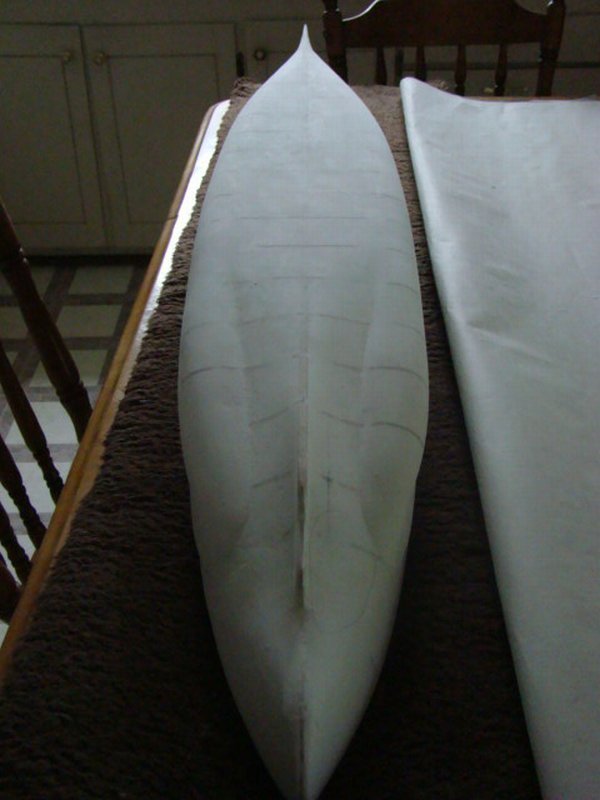

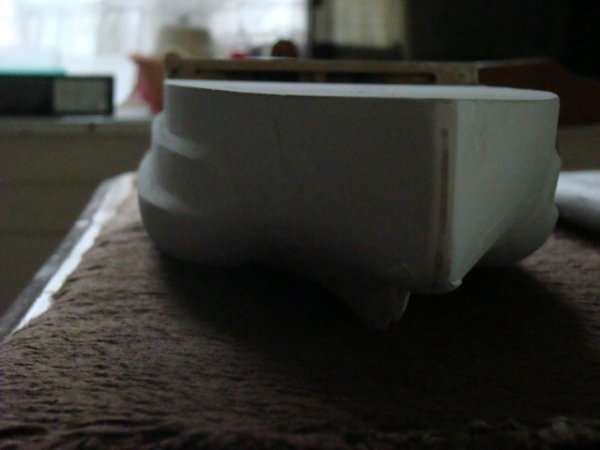

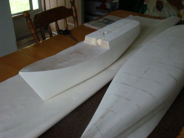

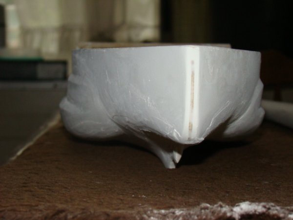

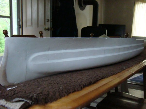

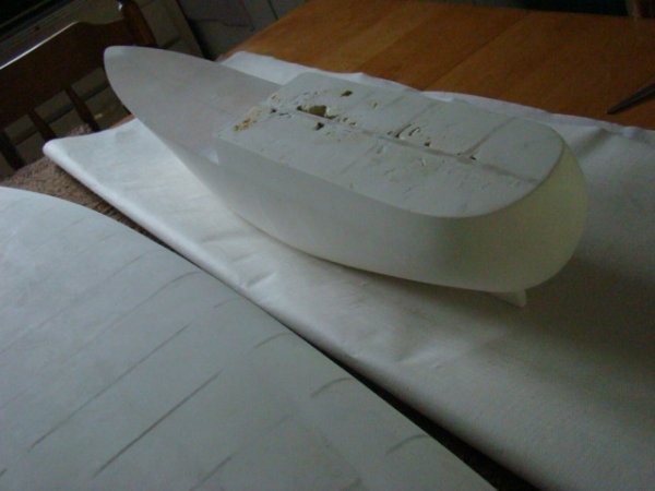

    Here are pics of the new QE plug,
    The other plug is a Soviet AGI in 1/72.
    It could be used as a convoy ship.
    There you go, enjoy.

  11. NickMyers
    ..Never seen that before. Try this...
  12. bb26
    Nice plug for the QE.
  13. Jay Jennings
    Thanks Nick, that was the third attempt at posting those pics,
    I think there was a glitch in the computer or the site.
    But you are right Paul, it is a nice looking plug.
