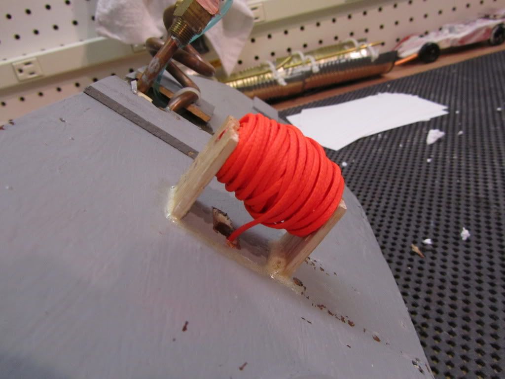

    Update on today: got my linkages set, starting a recovery system with a fishing lure and my smoke stack: drilled a hole in my smoke stack and widened it with my dremel tool. After that, I made a spool with a plastic tube and an aluminum one mounted on two balsa posts.they're drying as we speak with Elmer's GlueAll glue. I prefer this over Gorilla Glue because it doesn't smell, and doesn't need to be wetted. I'm going to paint the parts tomorrow, as well as CA soak the wood with a layer of epoxy. Pictures will be up tomorrow at my photobucket, http://s1175.photobucket.com/albums/r631/SHAMOOKILLU/

    I've seen too many floats fail when hidden inside the smoke stack. It's too easy to get stuck if the ship doesn't sink level. You may consider using a chunk of superstructure as a float, such as the forward bridge. Not only will it have more buoyancy, it is also less likely to get stuck if the boat sinks at an odd angle and provides more space to stow the float line. I like the spool idea, though. I've never seen one myself, but I've seen pictures of a few. That should help managing the float line, which used to get tangled on a few of my older ships.

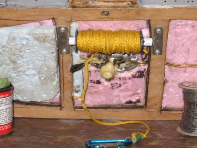

  9. rarena

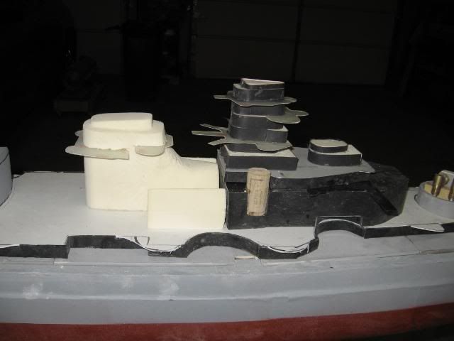

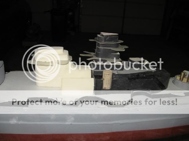

    I make the superstructure up on a thin wood base that fits the ship. Everything else is blocks of insulation foam (blue or pink from Lowes/home cheepo) with thicker rubber glued to the outside. You need a glue that does not dissolve foam. An alternative I have been trying is "foamie" from the craft store. It glues together with super glue but you may still need the thicker rubber on the outside cause it will take a beating. I use stuff close to the "grey wolf" termite armor available at Battler's connection for the outside thicker rubber.\
    here is a shot of Foamie
    here is a shot of foam with rubber over it.

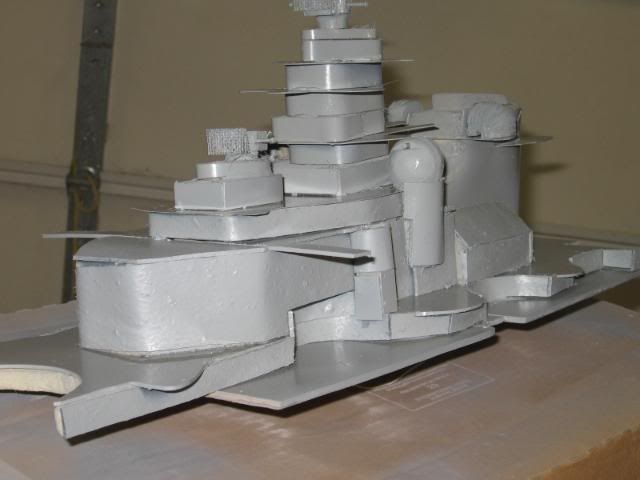

  10. NickMyers
    Something to consider, youll need a way to hold that tiny piece of superstructure on until youve actually sunk.
    Also looking at your pictures, its a bit hard to tell the size of your drag discs vs drive prop size, but check and make sure the disks are not larger. (diameter is the dimension of interest here).
  11. Kotori87
    3,562
    Before you carve up your nice superstructure, check and see if the bridge area floats without modification. If it does, you're fine. Nick raises a good point about keeping the float on until you sink. I've seen several floats get knocked out in the middle of battle. It can be very dangerous to drag your float line around, since it can tangle your props or another ship's props, possibly burning up motors and electrical systems.
  12. rarena
    The front piece is your best float shot but you might want to detach it from that deck. Maybe a few loose pins (1") on the deck for it to rest on
    I'm also leary of the angle of those dogbones. I would make sure I have spares.
    The boat looks fairly complete. I would tinker with it and get it back running or out on the water. It's a good chance to get the motors running, rudders, figure out how to make power run without fear of burning out expensive electronics, guns firing, ect
    Quite a score.
