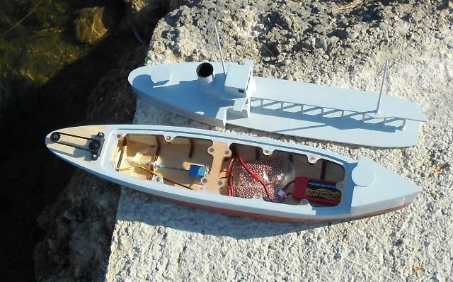

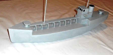

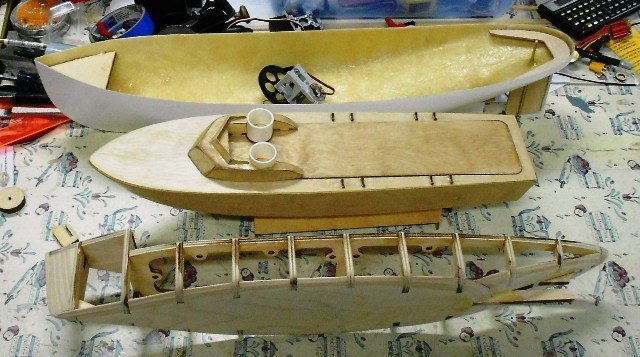

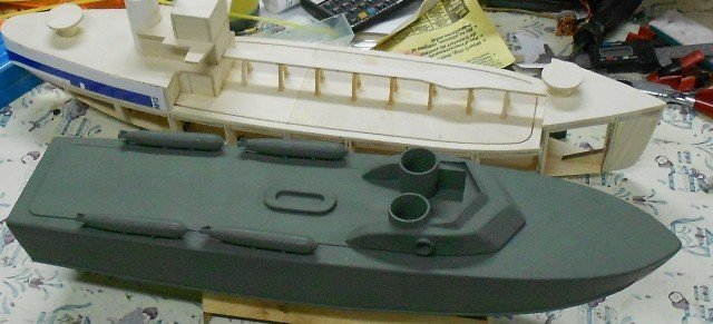

    Given the popularity of the Golo in 144 scale, I thought that a similar sized ship in Battlestations may create a little interest. So I found a little yard oiler just 174' long with a single prop for simplicity. The YOG 05 class oilers were self-propelled gasoline barges.
    Basic shell - about 22" long, so shorter than the 144 Golo but bigger than my 1/48 scale PT boat.
    Assembled with superstructure. Corrugated plastic board forms the outside of the stern deck house. It's a great use of all those political signs.
    Sheeted, partially painted and ready for installation of hardware.
    Interior. I didn't have time to put a pump in or fit the internal armor, so 15 oz of lead was added to make the waterline. The motor is a 130 size driving a 3/4" prop. At 50% throttle it draws about 0.5 Amps. A 1450 mAhr 2S LiFe battery should provide about 2 hours of run time. No room for the rudder servo under the deck, so it is mounted on the deck and protected by the outside of the first level superstructure.

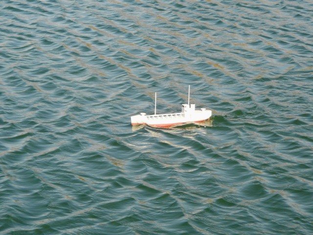

    Shakedown cruise in moderately rough waters. With 1/2" of freeboard, the deck is definitely wet.
    Cool idea!
  3. rcengr
    A better photo of the shakedown cruise, thanks to Mikey.
