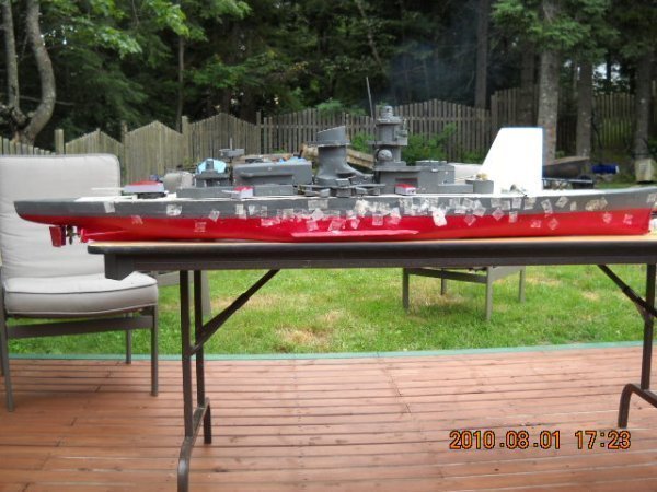

    Hi, sorry it took so long. Here are a couple pics showing the various states of my Scharnhorst. I am going to put a thread in the constuction forum on the refit, but will put a couple inside pics here.

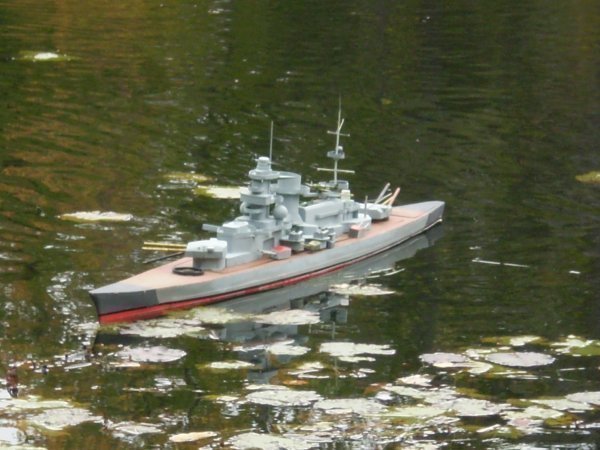

    Scharnhorst when I got her,

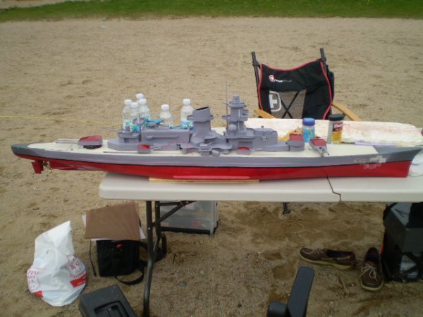

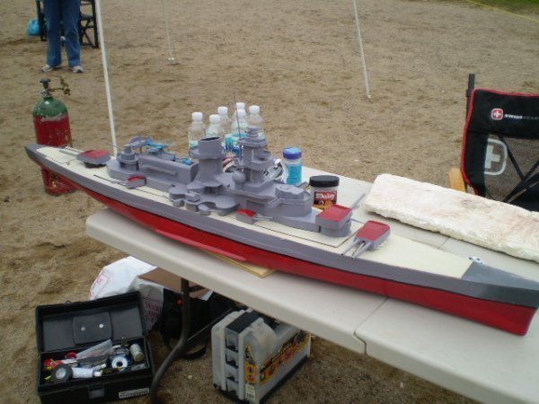

    A couple after the first refit, at CANNATS 10,
    Time for another re-SHEET and it turned into another re-FIT , amazing how that happens,

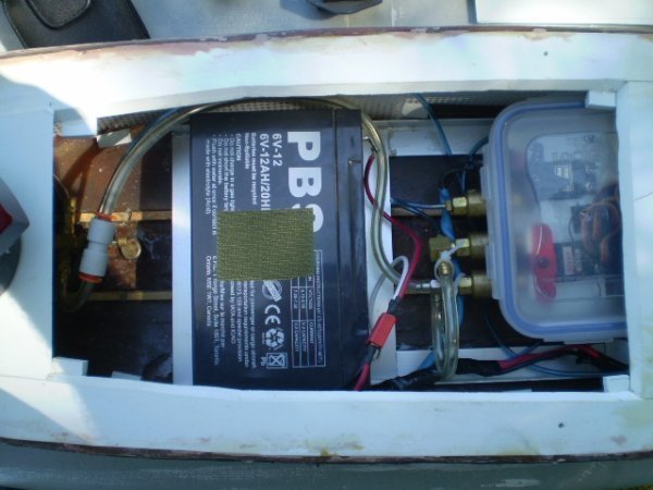

    This is fwd midships the bow is left, the bottle and reg are under there,

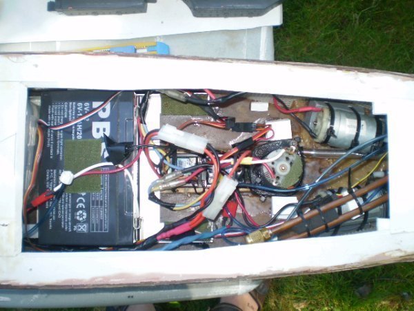

    This is the aft battery back to the motors. I have two drive motors with gearboxes and Scharnhorst has never worked better. During sea trials, I was able to accelerate, decelerate, go in reverse, and turn with Steve Crane’s Nagato. Overall I am very happy with the conversion.

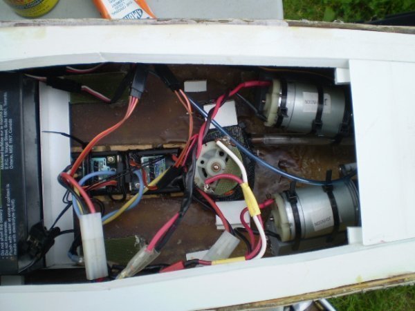

    A less cluttered view here. You can see the ESCs in the water channel. The pump will actually be a little farther back in the final configuration.

    two batteries, lots of power. is that a aluminum frame under the forward battery, otter box and aft battery. with a channel to faunally the water to the bilge pump. also, there are two engines, must have dual props, ours only has one engine. two speed controllers, one for each engine I take it? or other. Like the supper structure, nice look.

    2 batteries yes, looking to put a third, smaller one exclusively for the pump. I use 1/2 inch angle aluminum for my battery tray. It is GOOPed into place and has never moved. The water is channelled to the pump and cool the ESCs at the same time. I did put two props to improve the accell/ decell performance and I was rewarded. I am now able to match the performance of Steve Crane's Nagato ( no biggie unless you have fought against it) HIs boat always out performed mine. My turning wasn't negatively affected either. Overall I am very happy with it now. The SS is the one John Coffil built years age and has lasted really well, but wood eventually needs to be replaced. I am planning to get to that soon.
