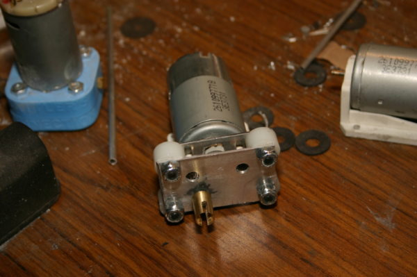

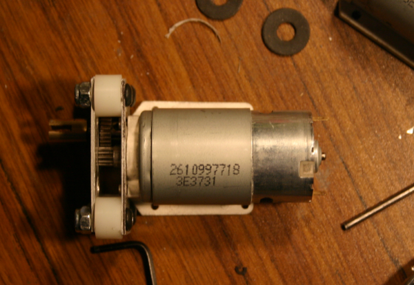

    I took some photos of one of the NJ's new "wing" transmission, for one of the two outside props.
    The material is (tested) no rust stainless steel. The gears I used are RRP. They are 35T & 12T for an (approx) overall ratio of 1:3. Yes they are both metal, but with lub they are not terribly noisy on their own.
    Notice how close the gears are to the TVPs; but they will not touch because I embedded metal spacers in the TVP. These spacers go the whole way through the TVP to make sure the rotation of the shaft will not wear down the TVP itself (which was the killer of my first design)
    TIP: Use / create spacers for similar designs; otherwise the rotation of the shaft will eventually wear down one side of the tvp & invoke a vibration which will beat away at the TVP until a large enough hole is made to create a jam or worse.
    Functionally, I think I did a pretty good job. I've slammed it back an forth using the motor; but the real test (as always) will come on sea trials.
