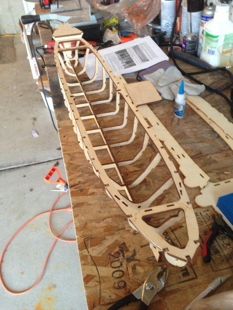

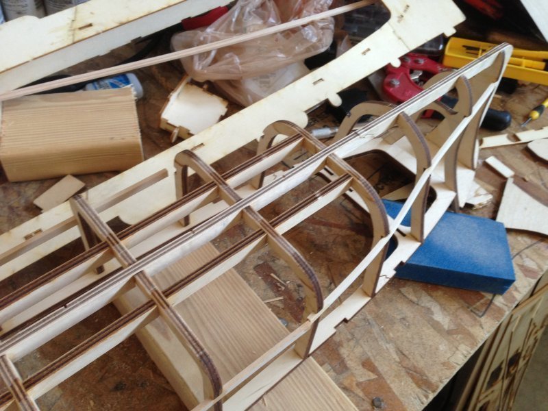

    Taking pieces of the ship out of the frames has been pretty exciting, but I'm just a little unsure of how this thing is supposed to be put together. The initial confusion was caused due to me not understanding which parts were what, but thankfully the instructions have been a great help, and the connectors very well designed leading to the following picture. I haven't glued anything yet but for starters I've taken the keel and cut the nubs off as well as taken out part of the flight deck(?) to see how things go together.
    So here's my first question: The instructions from here state to glue the keel pieces together. I was wondering if it causes any issues to put the glue inside the joints? The way the instructions read, you put them together and then glue it suggesting the glue holds the joints together from the outside. Also, I've got two different types of superglue right now, one is some Gorilla Glue and the other is a thick modeling glue used for plastic figurines but I am sure it'll hold onto wood just fine. Most people seem to advise on using a thin super glue, which I can get a hold of, but I wondered if it make a difference. Thoughts?

    RE: Bogue Carrier Construction (Newbie) No reason you cant build it to Big Gun rules. :)
  3. mike5334
    RE: Bogue Carrier Construction (Newbie) If I remember right, the assemble and glue type of building works best with thin CA that will wick down into the joints and corners for a strong joint. Thicker CA won't work as well.
    Also remember that the framework will require waterproofing which could also add stength to the glue joints.

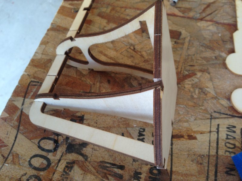

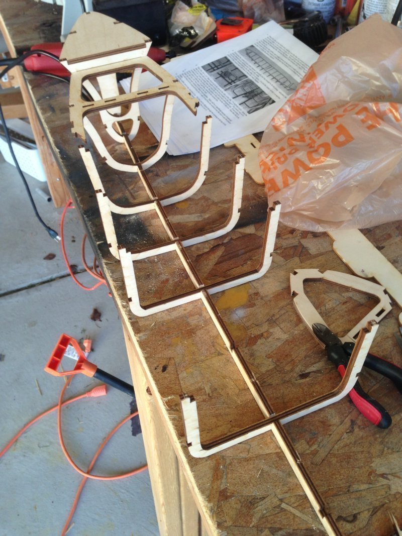

    Rib construction turned out to be easier than I thought. At first I used a dremil to file away at some of the joints, but as I inserted the third rib I noticed this caused the rib to sit higher than the others since the friction of the tight space wasn't holding it down. Oops! Snapped the rest into place using a spare chunk of ply board WITHOUT filing down the edges and it fits much better now!

    Based on feedback from our Turkish inspector, a quick look at the ribs revealed that the deck was warped due to the top rail pieces having not been fitted properly.
    Currently I have hammered out the problems with the deck and have one side glued and drying. I'll go rotate the piece and glue the other half tonight, but unfortunately that will be all the work I can do this week. Since I have this break to get some stuff ordered, I was wondering if anyone could make a recommendation on a pump to order and install. I will not be able to make my own and could use some advice.

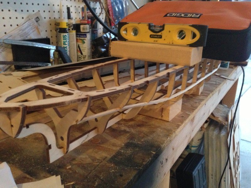

    On that note, I got looking at my stern and realized we are uneven. A quick check with a level bar showed a list to starboard, and I've already applied the superglue! I'm thinking next week I'll need to try and saw a chunk out of the supporting rib on the port side to try and level things off since it appears as though the problem is that I didn't get the stern deck set deep enough into the rib. Arrgh! :D
  9. rcengr
    It looks like you may have cut slots in the center keel, instead of the subdeck (step #2). If you go back and put cuts in the subdeck, it should be easier to get the ribs fully seated and the hull straight. Don't tear it apart if you have already glued the ribs, making the cuts in the top of the subdeck should work fine. The reason for the cuts is the deck has a curve - the 1/4" subdeck is too stiff to assume the curve without the cuts.

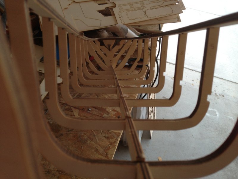

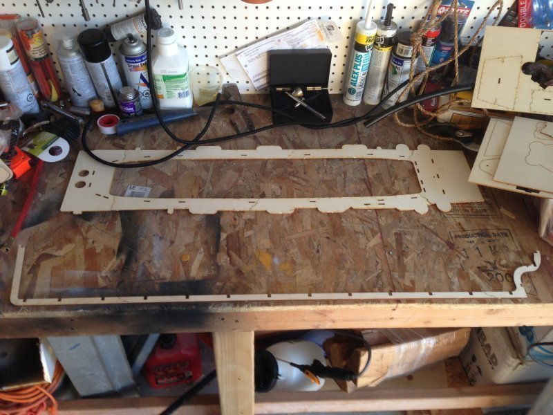

    Just wanted to let you guys know I haven't given up on my ship yet. I've assembled the flight deck as well as the water channel in the ship. I'm working on the bass wood rail right now and am getting close to sheeting the bottom.

    Water channel set
    Railing set also.
    I've got a bit of sanding ahead of me tomorrow, but after that and a trip to Carson City this weekend, I'll be working on the plywood bottom, and to be honest I feel just a bit intimidated by it. Any advice?
