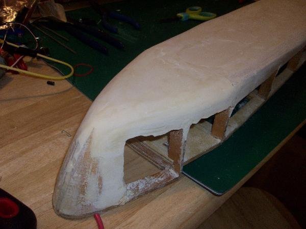

  4. NickMyers

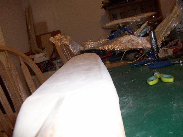

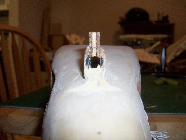

    Pic from before glass: Hull is shaped
  5. NickMyers
    Good timing, I'm just uploading old pictures and grabbing some fresh ones

    What is the white stuff you shaped the hull with?
    --Chase
    Sweet.
    Thanks.
  8. NickMyers
    Yeah, realized after I linked them that I hadn't chopped em down before uploading.
    Wood Filler, Elmers indoor/outdoor. Shapes pretty well, easy enough to sand. Never doing it again though, not confident that it will hold longterm the bond between the frames and the fiberglass. If it gets wet and stays wet even after its dry, it gets soggy, which means it has to be sealed up real well. Pain.

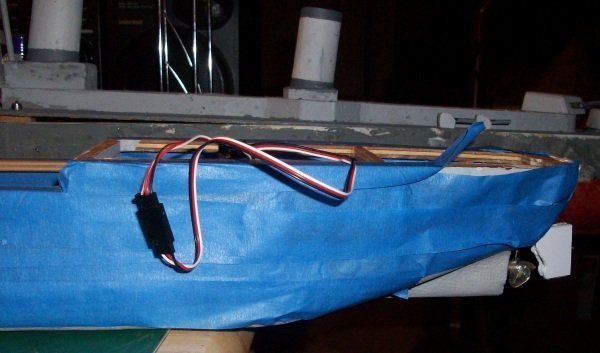

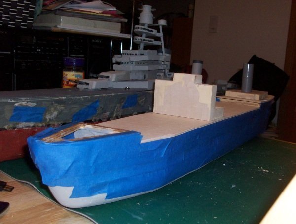

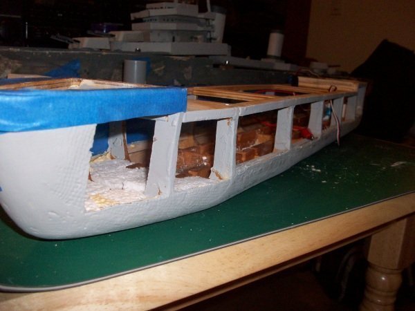

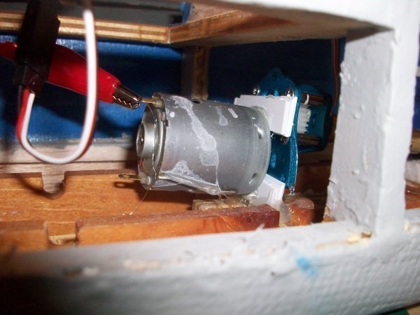

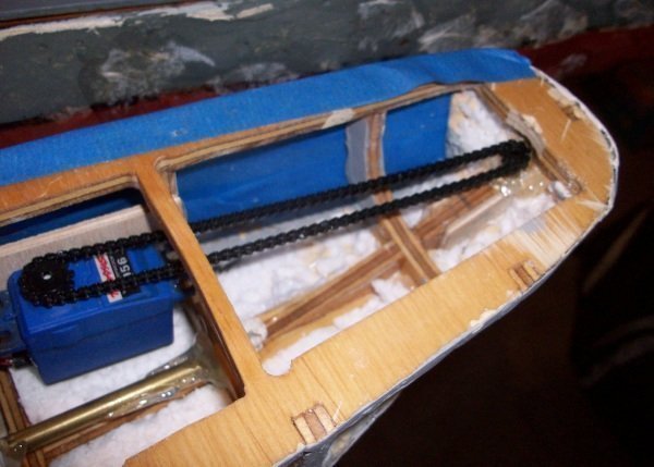

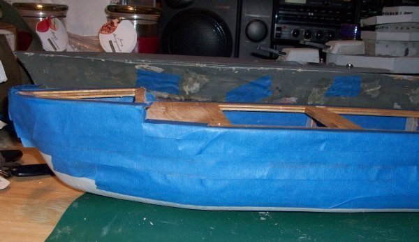

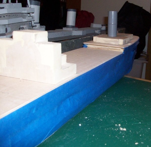

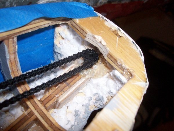

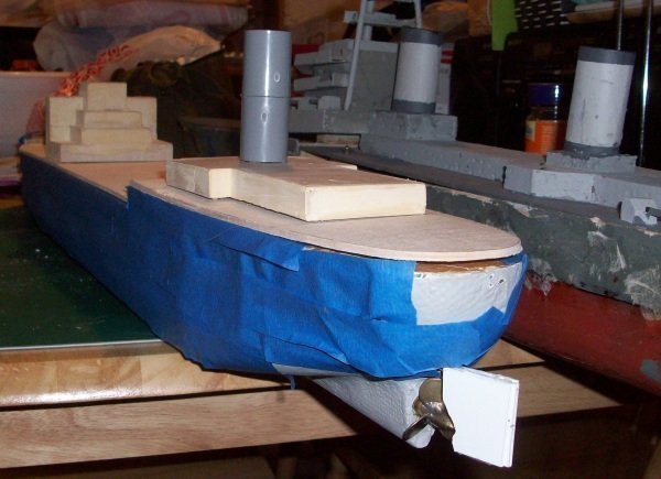

    We had our last battle of the year today, so I spent the morning kludging together a quick drivetrain and a rudder/ I was intending to bring balsa with me that i had silkspanned already and side it pond-side, but in my haste this morning I forgot the balsa, so I decided the next best plan was to sheet it in painters tape.
    This would have been a fine plan, if the thing had even remotely enough ballast in it. Needless to say it drafted about an inch, making the prop and rudder nearly ineffective. Attempts to ballast with available ballast material (rocks and batteries) proved unsuccessful, and my silly attempt to tape a battery to the after deck caused it to roll over and drench my non-waterproofed, held together by alligator clips electronics. Oops.
    Unfortunately, as a result of its only brief time on the water, no photographic evidence of its brief floating exists. Next test will have to be in the bathtub I think.

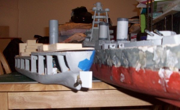

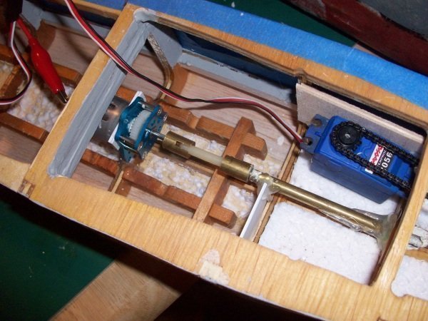

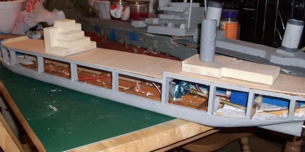

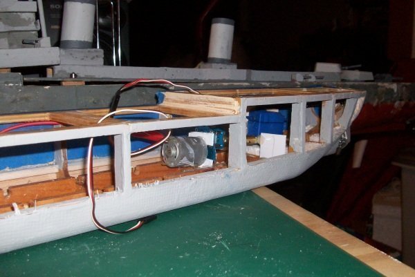

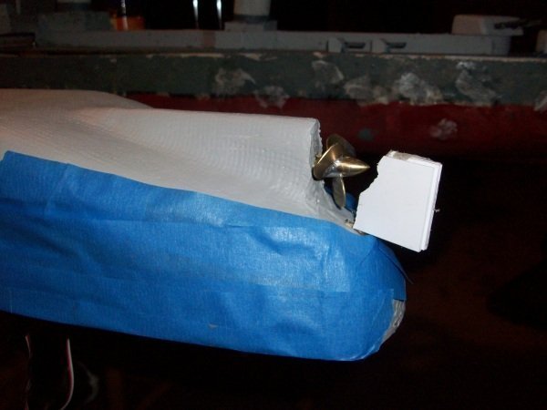

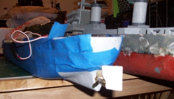

    Anyways, some pictures of the kludging. Also note that the hull has 2 layers of fiberglass on the bottom, bow and stern, painted up grey.

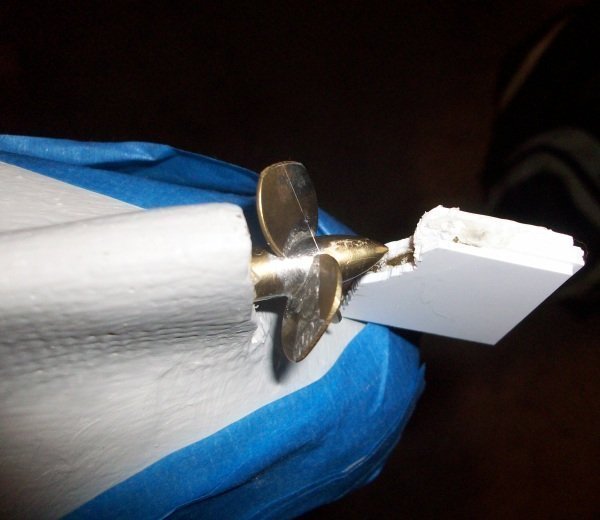

    The prop is actually set into the skeg a bit -it was too long to be able to mount the rudder in a semi-reasonable position. The rudder was formed by plating sections of styrene around a brass shaft - angled to dodge the prop and then carved to rough shape with an xacto knife. It will be getting redone (the glue didnt dry fast enough for me, so it too got hit with the hot glue gun). The bottom end of the rudder's shaft is also not supported by a bearing currently.
  11. NickMyers
    For the curious, thats the Suffren parked next to the Maru.

  17. Kotori87
    Nick, if you ever get access to machine tools, consider turning down the hub of that prop so it fits better. If a lathe isn't available, consider using a dremel and grinding wheel. Also, a skinnier (more hydrodynamic) rudder would help a lot, too. I like making rudders out of soldered sheet brass, but I've also seen them built out of wood in the same fashion you did, and then sanded down to shape.
    Question: what did you think of the ribs in the stern area? Did they get the correct shape across? that area was particularly rough on my CAD-modeling skills, and I was never very confident about those ribs.
  18. NickMyers
    The rudder is definately getting replaced. It sits too high, is too short and as you pointed out, it has a horrible profile. But seeing as I made it in 15 minutes and stuck it together with a hot glue gun... it is what it is.
    As for turning down the prop - I'd rather actually cut into the keel section and remove 1/4" of material, that way I'm not reliant on a specially modified prop - we have a lot of rocks in our ponds up here and breaking off blades does happen (Phil's river tugboat left on sunday with only 1 blade left on each prop, originally 4 blades each a few months ago - largely a product of his young son running her backwards into shore).
    Stern area, when I drew up my plans for it I actually had to adjust some ribs and interpolate new positions and scale them in order to meet IRCWCC rules, so I can't vouch for how close mine ended up being to yours, though I think pretty close. I'm actually fairly happy with the general shape back there, any real issues with it stem more from laziness on my part than a failure of the plans I think.
