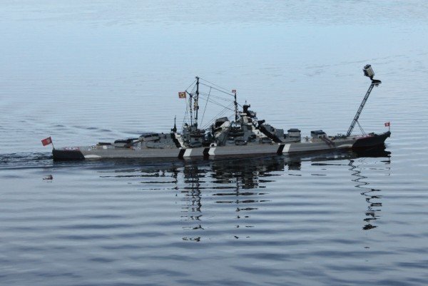

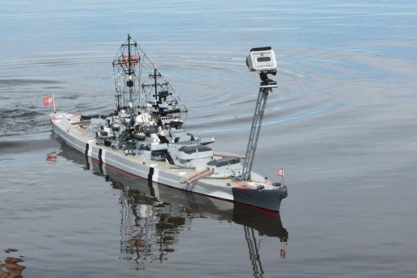

    Camera mount is finished and installed on board the Forcastle between the Capstains. We almost lost the armature when on the last phase of drilling a hole out on a bracket midway up the mount the drill press drill bit caught the brackett and ripped it out of our hands and twitsted the steel bracket into a pretzel. It took an hour to straighten it and pound out the bends. Reinstalled the platform brackets and installed the bolts. The mount is bolted to the deck and the camera is bolted to the mount. Total height estimate about 14 inches above deck. We made a triangle rod to support the rear of the mount and the lower ends are secured through the deck of the forecastle. We tested it for vibration and shock by moving the hull around to simulate bumps and sudden stops. The mount and camera barely moved. We took 4 different pics starting from horizontal , then bridge looking downward, then B then A Turret downward view. The 2nd view looking at the bridge from the camera at the bow but at height gave the best view Nearly 170 degrees around the ship. Both A and B turret cannons can be clearly seen with plenty of range from them so bb splashes from them will be seen. The view also allows ships passing withn the stern to be seen and the rear cannon shots can be observed.

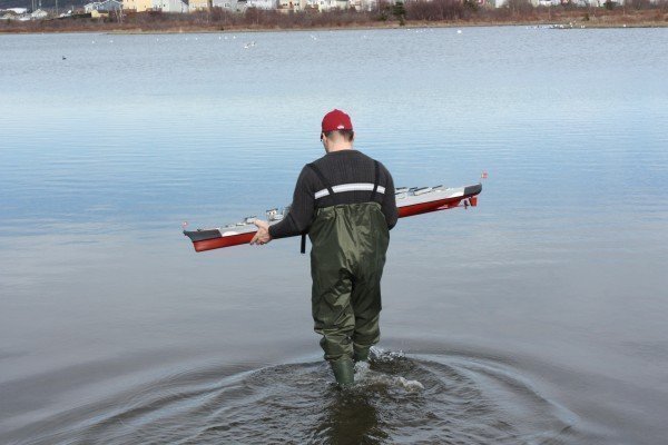

    Bismarck was finally floated today. Conditions were on the cool side temp wise but the water was like glass inshore with a mild breeze offshore. Skys blue and Sunny.
    Well the model was floated at full battle load first without the camera mount and camera attached and then with the camera and mount. No significant difference in how the model sat. Trim was perfect bow to stern and port to stbd. The model sat at the waterline. The model had perfect trim. The model was leaned to one side and let go to see how long it took to return to center. It right in only a few seconds and remained stable. We rocked it more with waves and banged the bow and stern and the sides to see how the camera mount held up. THe camera barely moved and the mount worked like a charm.

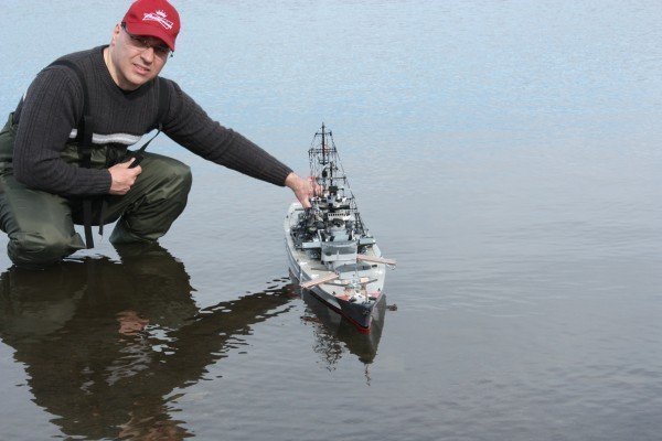

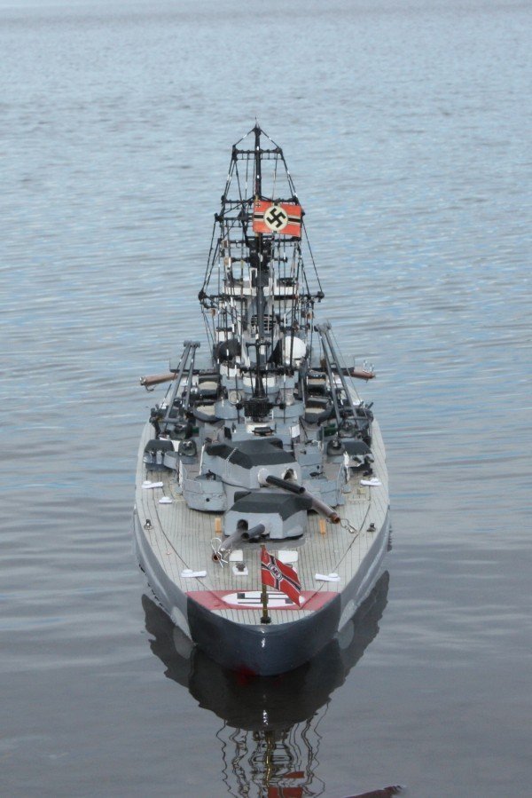

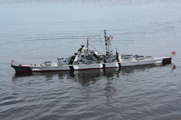

    Here are some pics ..enjoy...
