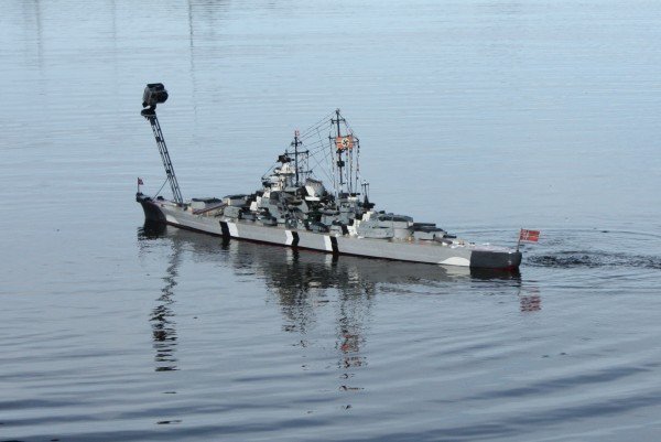

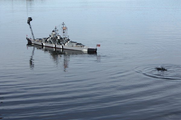

    The camera mount is very very stable when the model is bumped around.
  5. rarena
    The bis is a very good stable platform. You probably won't even notice the camera there. Man, she looks sweet on the water. What are the yellow things on deck? Now I need yellow thingys, Thanks! Can you get a closer shoot of the deck details?
