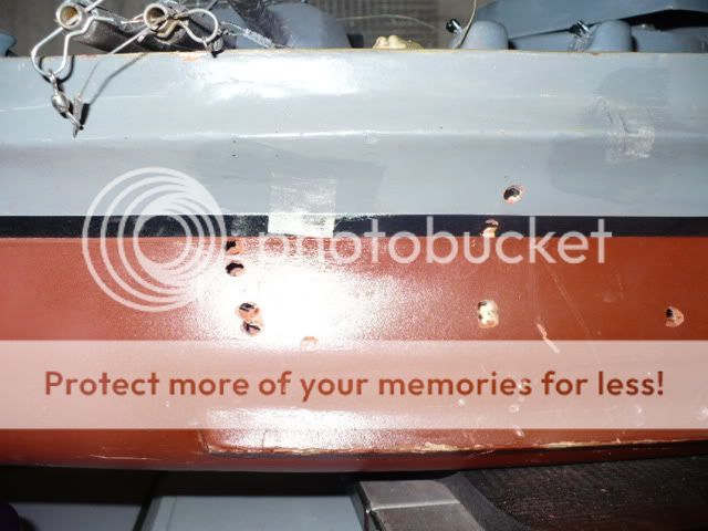

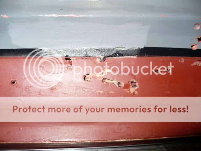

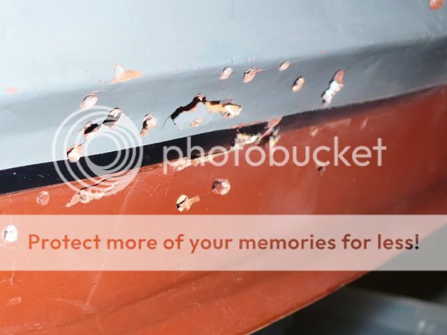

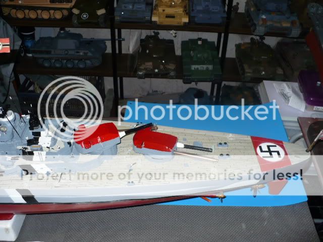

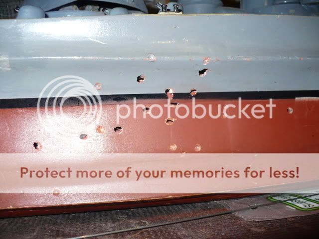

    Some addtional better pics of the damage to Yamato Port side from the new Bismarck aft weapons

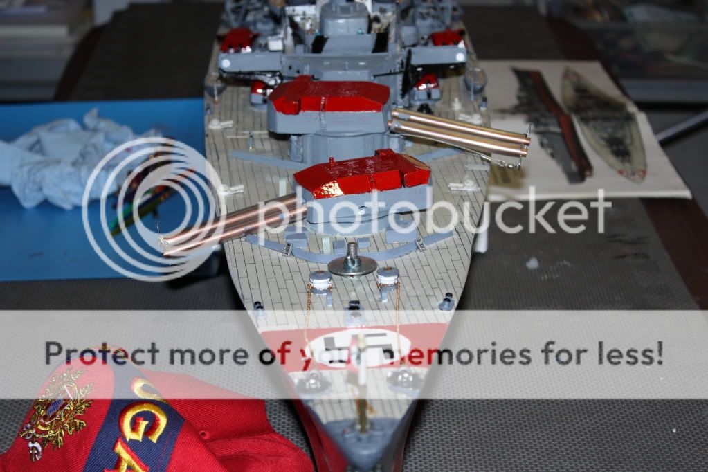

    Spectacular Curt. Well Done.

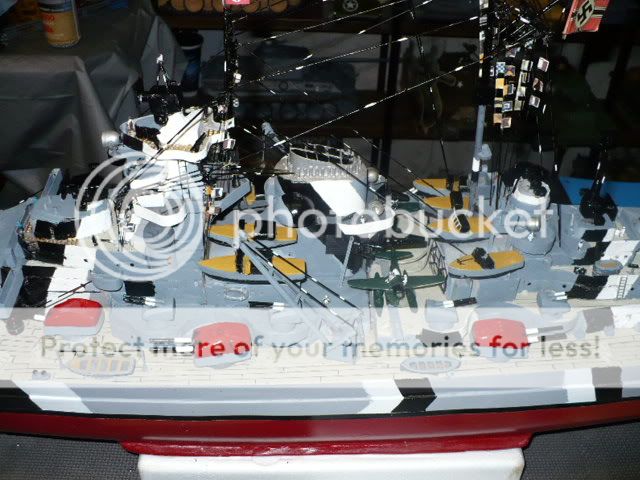

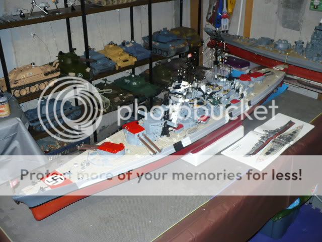

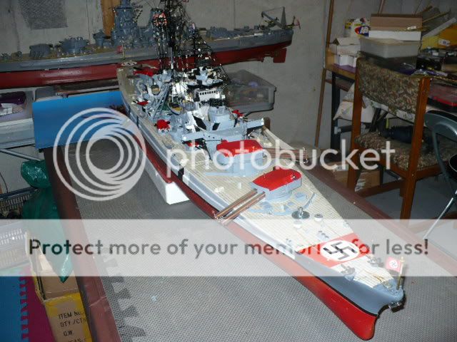

    Very nicely done, I can see my buddies drooling. The last time I went out in something that nice, my own team was shooting at me.
    I really like the little details and the turrets. Red is the color for those ship turrets, It has a history of being that ship from Canada. I considered that color early on because of yours.
    I think that's one of the main reasons I repurchased it from my good friend Chris Osborne back in 08 because it has a very good long history. It eventually would have been resold.Who knows what would have become of it. Thanks for the compliments Iceman.
    The Yamato 's hull damage caused by the Bismarck during test firing of it's guns has been repaired. Half of the crew from Bismarck were assigned to repair the hull and they reported that the hull has been repaired of battle damage. Next the Bismarck will be assigning a paint crew to hide those large repairs.
    The Bismarck Captain sent a fine bottle and sincere apologies to the Yamato Captain which was accepted graciously.
