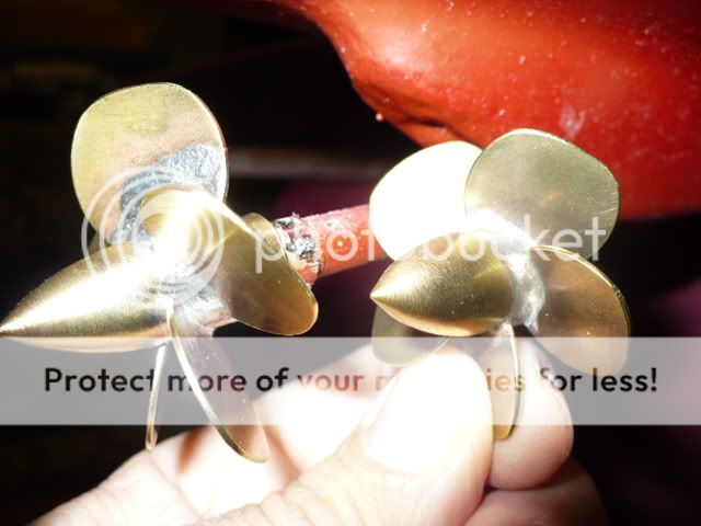

    UPDATE: New prop installed. Stephen did a great job making this prop. It's heavy but solid 5 blades.Smaller than the original. I think this will solve my problem. Will test Saturday if the weather holds up.

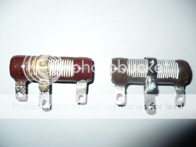

    UPDATE. I will be posting the pics of the new props and resistors to compare them with the old. The new resistors have more coils than the ones I been using so I should be able to tune down Bis on the large prop as I used to if I decide to go that route. Will post of the results after the next run.

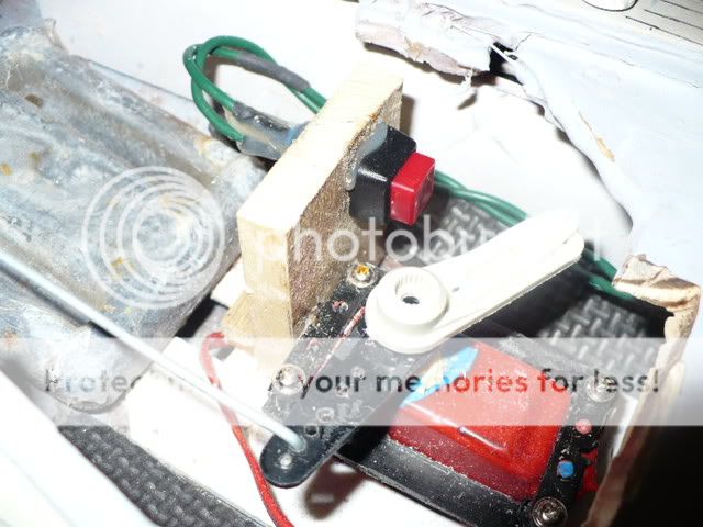

    UDATE: Light switch is now operational from the TX Toggle switch. The one that operates the landing gear. The Pump switch is fully operational and working. Now the only thing left is to try out the props and get the speed issue resolved and test the pump out again. If it's nice tomorrow I hope to finally complete the refit.

    The new prop is installed. Here it is next to the original prop

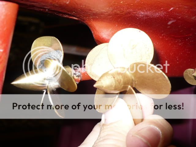

    Here is the 2nd smaller prop compared to the new prop

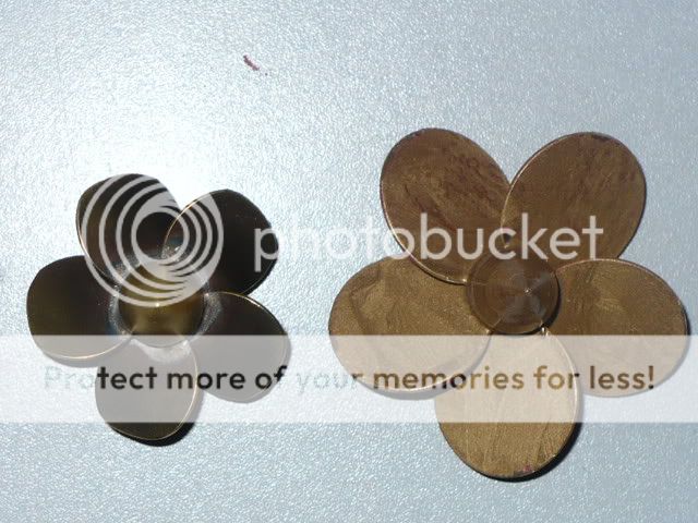

    A Front view of both props .
    A side by side comparison of the resistors. The RESISTOR on the left is what I was using to try and tune down Bismarck's speed. The Resistor on the right is from Strike and you can see that it has more coils for fine tuning than the left resistor. This is what Bismarck originally used with the large prop.
    This is the new pump activation switch. Works great and it's what I am used to. Never had issues with it when I had operated the pump from the rudder servo originally in Bismarck's early days.
    Another shot of the pump activation switch

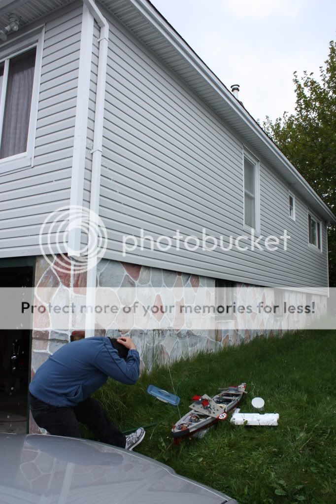

    Also I tested the pump out thoroughly today by flooding the hull slowly with a garden hose and seeing how the channeling was working and how the pump was evacuacting the water with the hull listing port or stbd down by the bow, down by the stern, and level. It worked very well in all trys and was able to evacuate most of the water.

    Tell me if what I see is a power switch that renders your boat dead in the water... We shot Ron C's switch last year and killed him dead. Then the beating began. That is right at water level. Best to sink it or bury it in some detail structure or something. You don't want your boat sitting there, you will have enough people trying to shoot the deck details as it is. Most people don't have a switch for that reason.
    Nope not a Power switch. Originally that was on the opposite side and was much larger. Never had issue without but I stopped using it in 2002. That's the receivor switch and the most that can happen with that is get shot off but the receivor will still be on. The 2ndary turret offers a lot of protection around it as the switch is between the barrels but just below the barrels. The switch has been there since day one and never had it hurt by bbs. The switch moves off and on facing the bow and stern not the other way so even if it's hit it won't shut off. You got a good EYE Iceman.

    SEA TRIAL #4 update. I just came back after testing out the new small replacement prop. It's 1 5/8 in dia 35 pitch blade 5 blade with a hub to fit the bismarck prop shaft which is very large.
    Results. Timed over a 50 ft course 6 times in both directions I hit the mark at 24 sec every time. Ship at full battle mode weight. There was a wind blowing offshore so I kept it close within 20 ft in the calm section of the lake.
    Maneuvering was good as well as stopping and going to rvse. Dead stop to full speed also was very good. The bow wave curled below the main anchors without touching them and the stern was not pulled down deeper by the prop while at speed. I had no issues pivoting the ship from dead stop to full with the rudders hard over from dead stop.
    After 1 hr of straight running I checked the motor for heat and as expected the motor temperature was down significantly.
    The ship ran without an ESC or a Speed Adjust resistor at 39 lbs ballast. The only drag props were the 3 blade 25 pitch .75 props.
    I am very pleased with this so I ordere 2 more from Strike.
