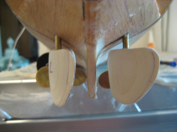

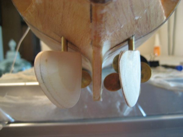

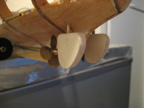

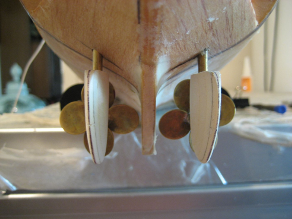

    I hate to be a wet blanket but part of the construction rules is that the rudders must be in a scale position in relation to the props.You cant just place the rudders directly behind the props unless the original had them that way. I would love to place the suffren rudders in a different place but I cant

    Looking at the plans he has here: http://www.rcnavalcombat.com/rcnavalcombat/FileManager/ViewFile.aspx?id=925
    I'd say his rudders look pretty close the the scale location when compared against the photos. I may be completely wrong though. :)

    I have two bearns and the rudders are definatly offset,however Iwas talking to mikey and he sais that the bbs and treaty are the only ones who try to enforce that rule all others put them where they will turn best
  4. mike5334
    I did build this ship primarily for fast gun and Treaty. In MWC/IRC, we are allowed leeway with rudder locations and prop locations to help a ship turn tighter. Admittedly, I didn't look close at the Treaty rules for rudder locations.
    This Bearn's rudders are very close to scale location. They are approximately 1/2 inch forward than the plan's location. Also, the props are about 1/4" further aft than the plan's prop location.

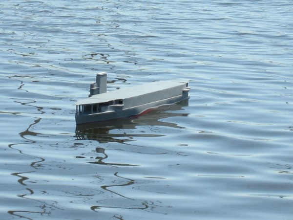

    Wondering how things went for the Bearn during the MWC Nats? Well, it was so so. The night before the first campain battle, I finished a basic superstructure for the Bearn and painted it literally hours before the battle. IMO, even without the railings, scale guns, and planes, the Bearn looked pretty good (pictures will be posted soon). The Bearn was the largest convoy ship out there too. During the campaine battle, the Bearn lost power in the middle of it's first run and ended up sinking in in the middle of the lake. It took a loooong time to sink too. heh.

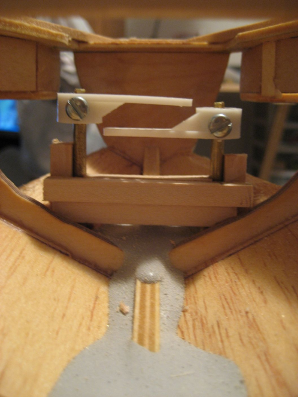

    That looks nice, and I really like the rudder linkage design. If my Queen Mary bleeds off too much speed in turns, I might give that a shot and see what it does for me. My Invincible already holds speed in turns really, really well. That's the one thing that really shocks people about her maneuverability is I can actually out run much faster boats in a turn. It's kind of a crutch for me in the Invincible, but not one I want to learn to live without right now!

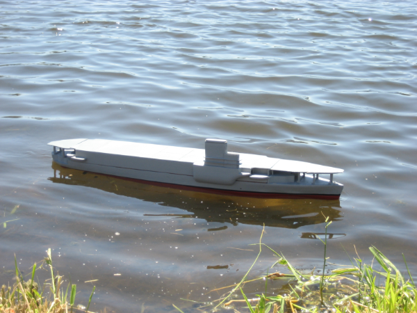

    Ok, here is a couple completed pictures of the Bearn literally hours before it's first convoy run. Not much detail has been added yet since I was very hard pressed for time just to have the ship ready for the MWC NATs. Like I mentioned in a previous post, the Bearn will get lots more details added after I return from Korea in August 2009. :)
    The Bearn at scale waterline, but sitting a little low in the stern.
