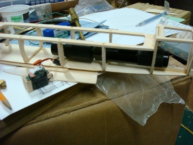

    RE: Almirante Villar (Orfey class) Whats the overall length and diameter on that co2 adapter + regulator arrangement? Trying to figure out where that will fit internally from looking at the picture posted.
    It's out in the shop at the moment, but here's a pic I had saved that shows it inside the hull: (the regulator is the thick section on the left)
    Beside it is a Spektrum microservo that I HOPE will have enough torque to do the job, in a tiny lil servo mount fabbed out of 1/4" ply.
  17. NickMyers
    RE: Almirante Villar (Orfey class) That eats alot of space up :(
    Hope that microservos up to the task, because I've got a pretty similar one that I intend to use for my rudder
