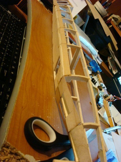

    I have Clemson plans on the hard drive, J... If you want to try it :) If I did a Clemson, I'd build it 1/16" wider and 1/2" longer to be within the rules but with as much bouyancy as possible, Adding the 1/32" battens to the ribs on el Almirante will displace roughly 1.4 more cubic inches of water than is strictly scale, which is 0.8 ounces (22g) of extra bouyancy. If you add the legal 1/2" of length to the midsection, it would be more significant.

    Adding the strips is a really good idea. Too bad I've already fiberglassed mine or I'd give it a shot. I guess I could make them a disposable part of the hull sheeting.
    I think if I were to build another one of these from scratch, I'd add 1/4" - 1/2" inch of depth to the hull and 1/8" - 1/16" to the beam. I haven't done the math, but I think with these two changes youd have enough displacement to be able to carry the weight needed for the full co2 system and cannon.

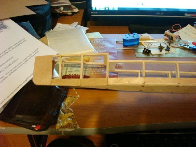

    Was sitting around tonite working inside (if I'm not making a huge mess, the wife allows it), putting some 1/64" ply on the hull which will get 'glassed over later. It is possible to just tack the glass on with CA glue and it will more or less hold the form, but it'll pull and form convex shapes and I don't like the look nor the loss of bouyancy which that entails. Some parts of the ply haven't been fully glued down yet, but you get the general idea of what I'm trying to do. Ignore the full-looking yet empty wallet in pic 2, it was the nearest object the right size to prop up the hull for the pic :) **Side note: The May battle in Savannah is going to be on 29/20 May, at which time, El Almirante will make it's combat debut. So I have a bunch of work to get done! I will be playing with it some on Sunday after I get back from camping with the Boy Scouts. But I'm ordering my batteries before I leave for the weekend so that I can float test her and drive her around ASAP.

    RE: Almirante Villar (Orfey class) To get the curves right you could try to glue 1/8 inch balsa strips between the forms, glue the plywood onto it and then sand them out after glassing the outside of the ply.
