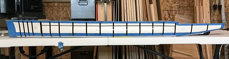

    Float test done and double checked. Going by the plans would have definitely made my windows too low by about 5/8"!!
    Need confirmation on my cut marking so I can start covering myself in dust. Thinking about staggering spacing between the first 4 in the bow a bit to close up the window before the 3/8" rib.

  3. Renodemona
    864
    Drop the stringer to the area of the bulge itself. If you change that 3/8 to a 1/4 and strip 1/8 of the bow you get another rib. Up to you.
  4. pigeonfarmboy
    Apr 26, 2016
    245
    Champaign, IL
    Ah good call. Wasn't sure on the position of the stringer. Going by the Strike instructions, this is where it shows to put it. I also hadn't considered taking area from the bow.
  5. Renodemona
    864
    Stringers are there so you can sheet over bulges and whatnot so they've got to be where the feature that justifies them is. I also like them out at the wider spots of bulges because that's where you're likely to get ram damage if you do get hit and it helps to have not such a huge hole. It's not so much a problem on a cruiser, but why invite disaster ;)

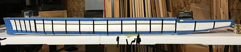

  6. pigeonfarmboy
    Apr 26, 2016
    245
    Champaign, IL
    Got the stringer and first ribs shifted around a bit. Think I'm happy with this layout.

  7. pigeonfarmboy
    Apr 26, 2016
    245
    Champaign, IL
    Well nobody is telling me it's wrong so I'm gonna put grinding wheel to it tomorrow.

  8. NickMyers
    noooo waiitttttttt
    actually it looks fine from my chair here. don't suppose flickr lets you embed larger? 800px is out of style these days. :)

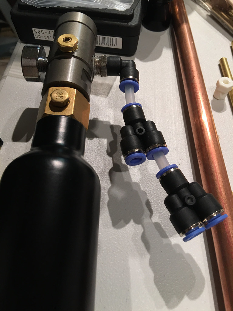

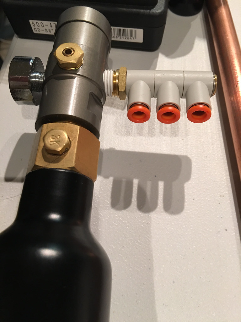

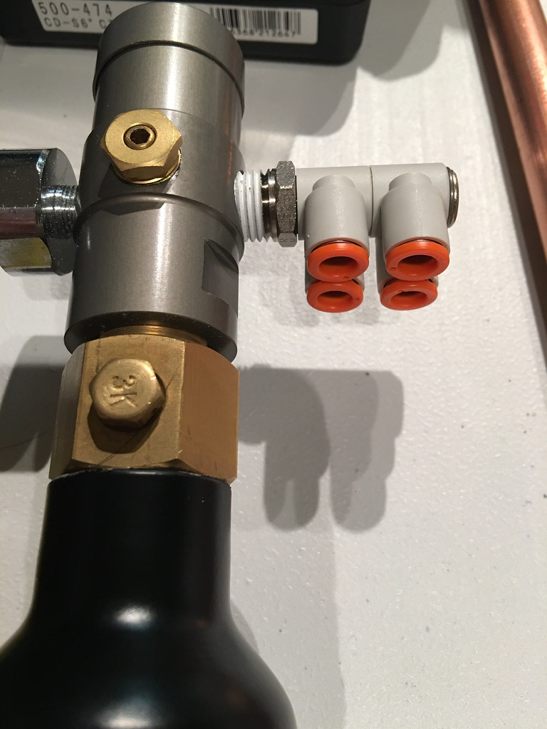

  10. pigeonfarmboy
    Apr 26, 2016
    245
    Champaign, IL
    Plumbing the cannons I realized I didn't know if the required 10-32 test port is male or female? Trying to come up with something that mates to a 1/4 PTC fitting.
    Option #1. 2x "Y" Adapters (290 psi)
    Option #2. 3 port Manifold (only rated for 145psi) "T" fitting would be used for pressure test port
    Option #3. 4 port manifold (also 145psi) Test port straight into PTC fitting

  13. absolutek
    Just get a ptc to 10-32 female fitting (and plug it when not testing with a 10-32 screw and rubber o-ring).
    Otherwise you'll just get the test rig hooked right up to your regulator. That's what they did for me when I didn't have the pressure test fitting.
  14. pigeonfarmboy
    Apr 26, 2016
    245
    Champaign, IL
    Duh! Mcmaster part#5779K443 Thanks Man!

  19. SteveT44
    Drill and tap a 10-32 hole in the end of the option 2 or 3 fittings and you're good to go!
