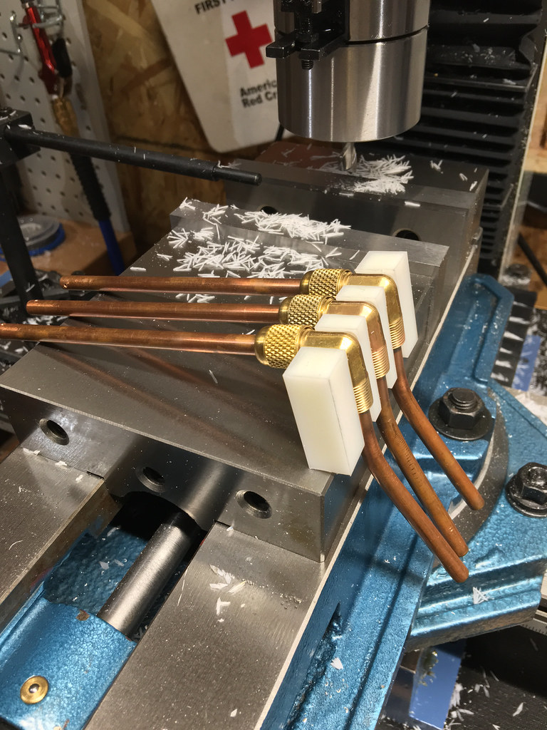

    Playing with different ideas for cannon mounting

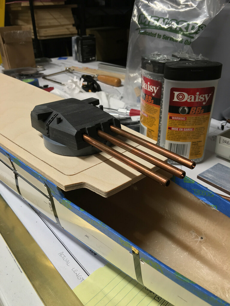

    Got the mount all sized up and functional. Now to mount it to the deck.

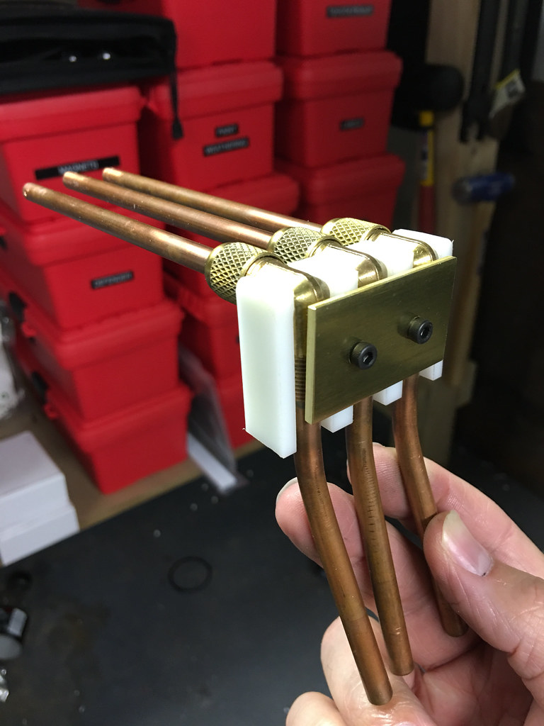

    Probably too wide for the Lutzow hull, but I designed a solenoid mount last night. Worst case I'll put this in a Bismarck later. This should help keep the weight low. I'll have to see if the 2 sides need to be angled to fit in the hull. My robot fabricator is at home making me a sample as I post this.

    It's definitely too wide for Lutzow so I made another flat version. The first "Low CG" version will work great in larger hulls. I'll make another mount for duals as well. Fitment is spot on. Just waiting for the other two to arrive. Might have to play with another mount to get these to lay flat and run 90 degree connectors.

    Got some mounts that will allow me to easily pull out each solenoid separately. They are simply a tight friction fit. Just need some minor tweaks to the housing to make sure the 90 elbow fittings will have clearance.
